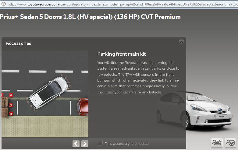

    Consider installing an aftermarket front parking sensor kit similar to the "Front Parking Main Kit" offered as accessory on the European Prius+/Prius v - see attached.

    I have Plus performance package. so i am lower and have ground effects. only bump parking block twice since i have owned it. but i tend to notice i kinda park far from them. that Europe parking main kit looks like it solve my issue.

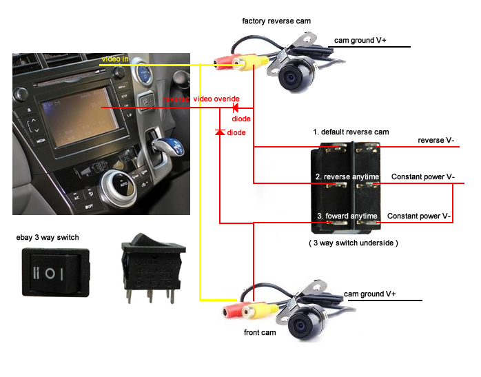

    I have an idea.
    What about a three way Reverse camera anytime switch which can also toggle between the front and reverse camera.
    The three settings for the 3 way rocker dash mounted switch would be:
    1. position 1: default: reverse cam behaviour (on when in reverse only)
    2. position 2: reverse cam anytime
    3. position 3: front cam anytime
    Have a look at my noob electronics schematic... Would it work? My electronics knowledge is limited btw. camera mods.jpg
