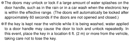

    Did you encounter the front door handle area that locks/unlocks all the doors when washing with your hand, and key fob in your pocket?
    Put the key fob in the house and try washing it again, in a few days when it needs another washing.

    Water from the hose will trip the lock/unlock trigger on the door handles when the fob is in my pocket while washing the Subaru.

    Happens with my 2010 at the car wash routinely. Owners' manual mentions it:

    I always disable the fob when washing my car. Hold down the lock button while pressing the unlock button twice. The fob light will blink twice. Pressing any button once it is disabled will re-enable the fob. I found this info in my 2017 Prius manual as well as in my 2022 Venza manual.
