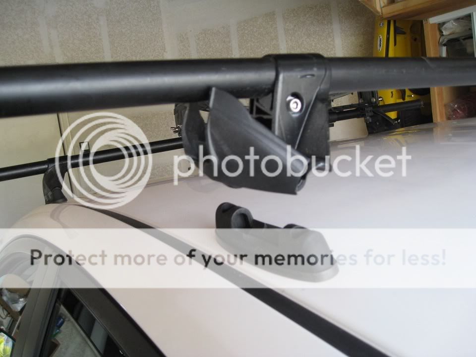

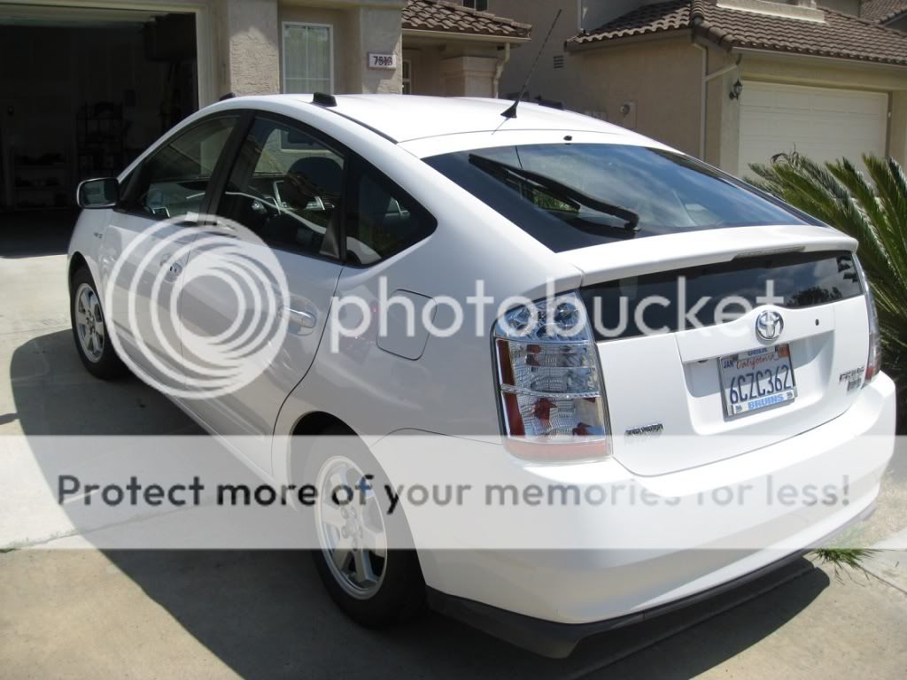

    I used to have a 2008 Prius with a Yakima Permanent Rack with 4 permanent landing pads and one pair of saddle and one pair of rollers. The set up worked well for me as I can put one end of the kayak on the rollers and push it up. However, with the Prius V, you can't use the roller because of the high tail so you have to use two pairs of saddles. If the kayak is too heavy, you might need somebody to help to lift it up unless you buy an expensive side load system.

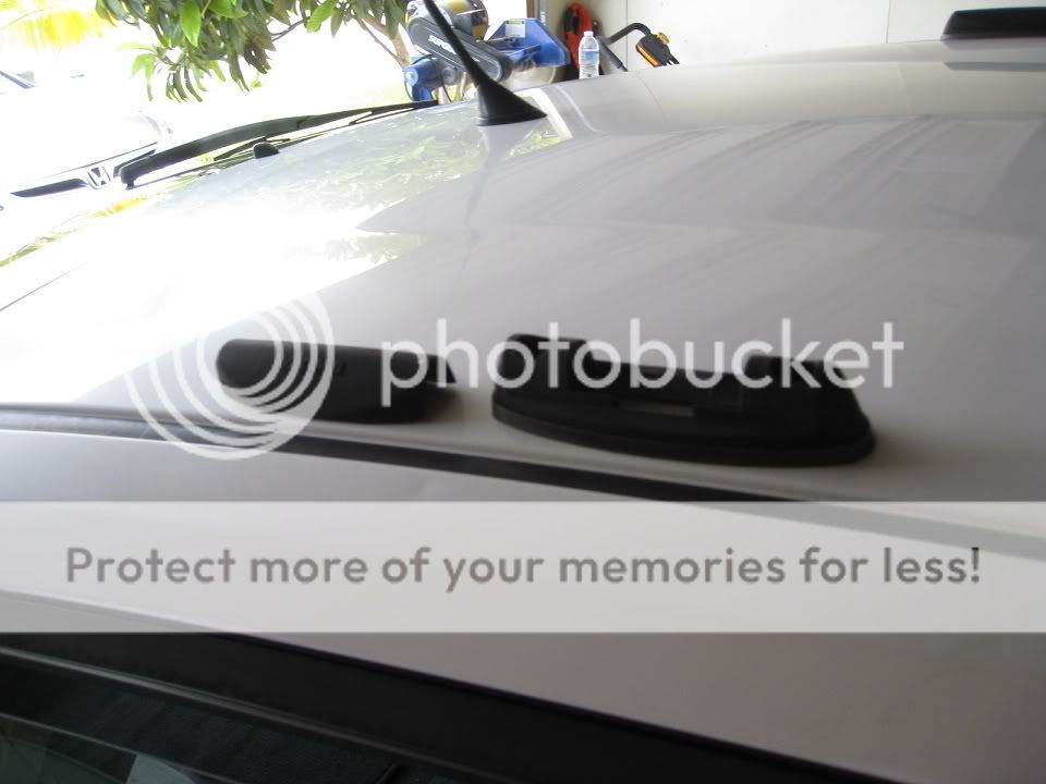

    These are great! How are the landing pads fastened?

    First drill two holes on the roof for each landing pad, then use two blind fasteners to fasten the landing pad down to the roof. There is a seal between the roof and the landing pad to ensure no seepage of water into the roof. When drilling do some research first to ensure that you don't drill into electrical wires or airbag components near the roof. When you buy the rack you will have full instructions.

    Yikes. Drilling into the roof...
    Research? Where would I go to find wiring diagrams?
    These look great, but I'm hesitant. Drilling into the roof makes me very nervous. No fix points I take it?
  10. pardreamer
    pardreamer Member
    Jan 30, 2008
    114
    San Diego
    Before drilling, I read one post from priuschat and that guy provided me the locations where he drilled so I just followed his lead. Just make sure you don't allow the drill bit to go in too deep and just hope.
