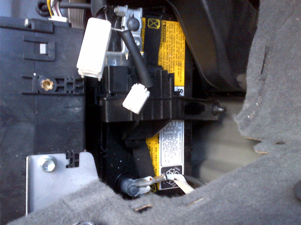

    All right, finally had the time and empty trunk to try this out.
    (and my Macgyver friend for backup and tools....)
    As both dolj and bisco mentioned, there are white plugs that can be pulled out - which will be a quicker way (at least for mechanical wimps like me) to reset the ECU. They mentioned 1 plug, I pulled both....
    Be careful with the plug on the right; it is unusually long so take care pulling it out all the way.

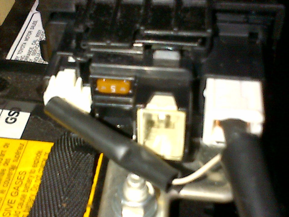

    I also noticed two fuses: one 5 amp, and one 50(?). I didn't pull those but maybe they will serve the same purpose as shutting down the battery?

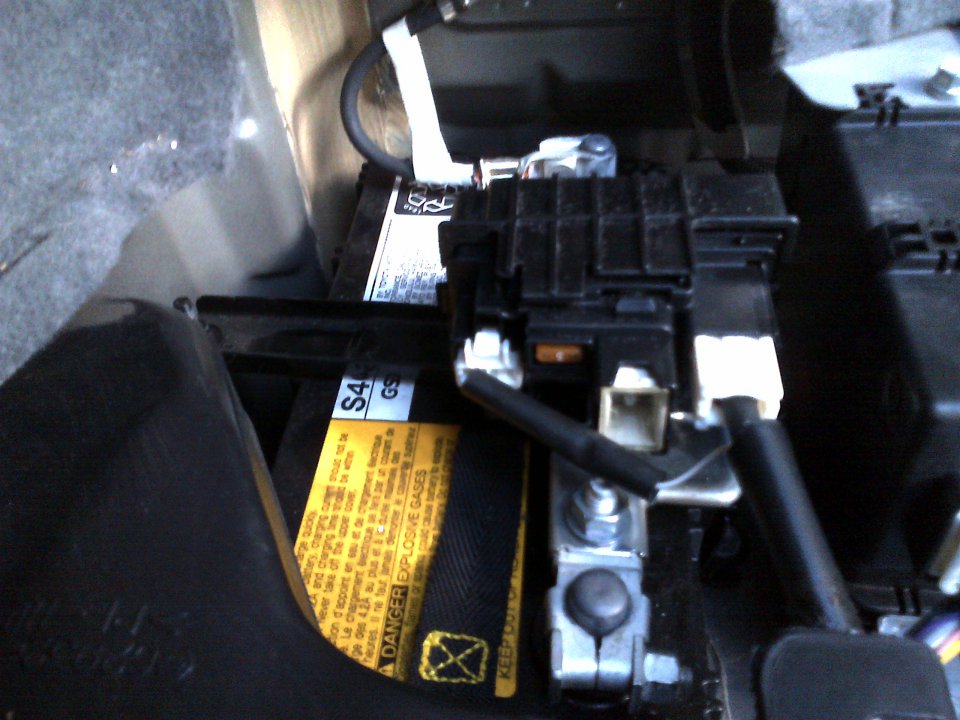

    DO NOT CLOSE THE HATCH if the plugs are still disconnected - it was no fun crawling from the backseat to reattach. :oops:
    It was 92F outside.
    Take care putting the long white plug (on the left in this pic.) all the way back in. It will click.
