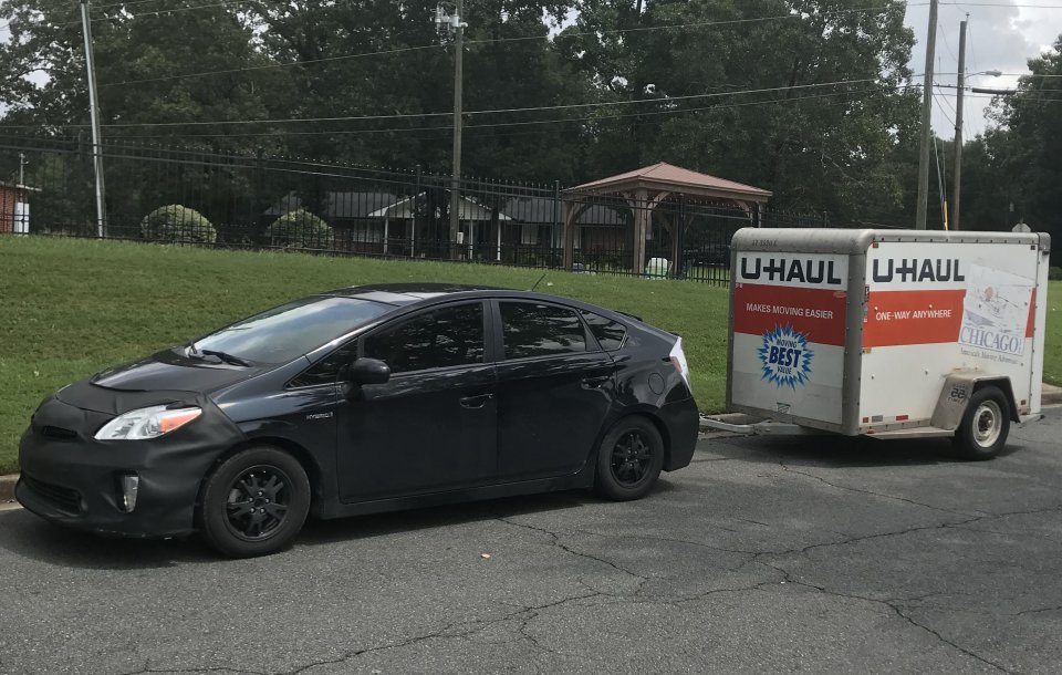

    Ask question. Get Answer. Yes.
    [​IMG] [​IMG]
