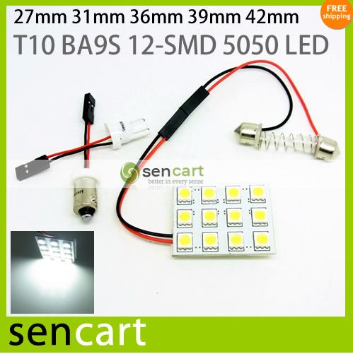

    Thank you Yakoma. I really like the idea for the center console. Has anyone tried something like the picture below and do you have any pictures of the install? I got the idea from Justdidit's thread. They can be had in 9smd, 12 smd and other configurations. They look like they may give out some great light.

    Those are super bright and SUPER cheap... I'll try to post up some pictures this wk.
