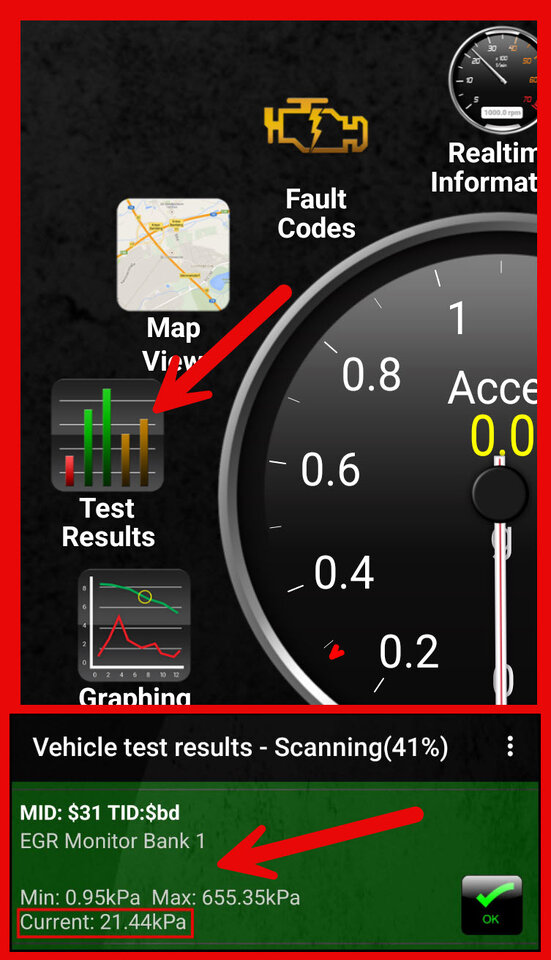

  12. wheezyglider
    wheezyglider Active Member
    Mar 12, 2011
    247
    178
    SF Bay Area
    After seeing that gnarly fuel pump filter photo Raytheeagle posted not too long ago, I'll never let my tank get low again. (Just hoping not to pump a bunch of sediment at once.)
    Regarding the monitoring of the EGR circuit via OBD, it would be interesting to see if the max commanded EGR changes before/after cleaning. As in, does the computer know to open the valve more when clogged in order to get what it needs? On my post-cooler-cleaning Prii, the computer never commands more than 60-70% from the EGR valve.
    There was a difference before/after on the "EGR flow insufficiency" monitor numbers, but there's currently no easy way to ask for that without using Techstream. (It's likely technically possible with an OBD2 dongle, but might not be as simple as discovering a custom PID for use with Torque. If I were selling Dr. Prius app, I'd definitely look into it. At the very least snoop the USB communication via usbcap while using Techstream to read the value. But I digress... )
    The EGR flow insufficiency monitor seems to be a test that runs (occasionally? once after warmup?) in the background, with the results stored by an ECU. As opposed to a sensor that updates in real time.
    To add to the list of things we don't quite know, it's not clear AFAIK if the EGR valve has a position sensor. It has a bunch of wires like a throttle (which often uses 2 wires for command, 3 for sensing position). The EGR valve has 6 wires ,so it might have a position sensor. But I don't think the custom PID for EGR Step ever mismatches EGR Commanded (--by more than sampling delay would explain).
    TLDR: we don't know how to monitor the EGR circuit, but the pieces might be there.

    I believe it is a stepper motor.
  15. tonynap
    tonynap Member
    Jan 13, 2019
    43
    38
    NY
    It is a stepper motor, and the step position has a PID so you can monitor it in Torque.
    The screen I ended up building is basically monitoring for the misfiring and high temperatures that seems to precede failures.
    The next thing I need to determine is the significance of a misfire count of 1. It's never 2, and it's never the same cylinder.
