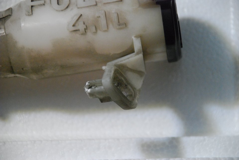

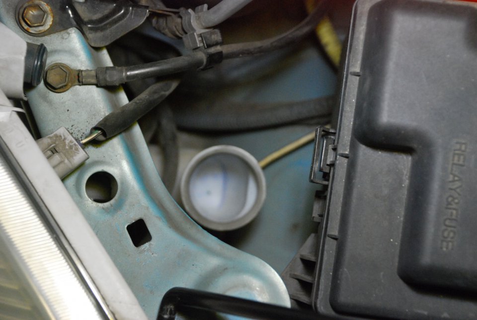

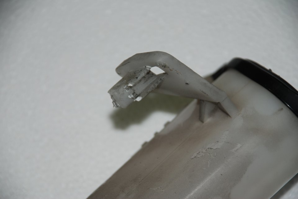

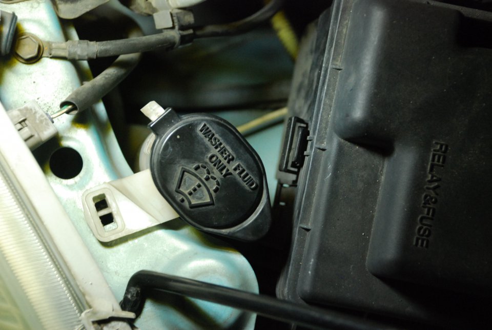

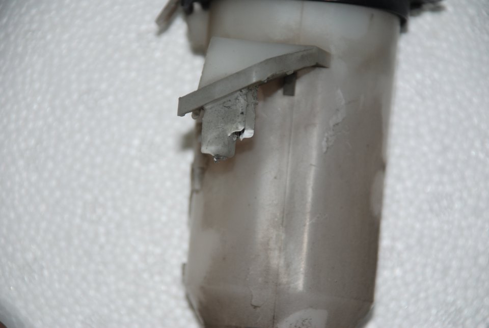

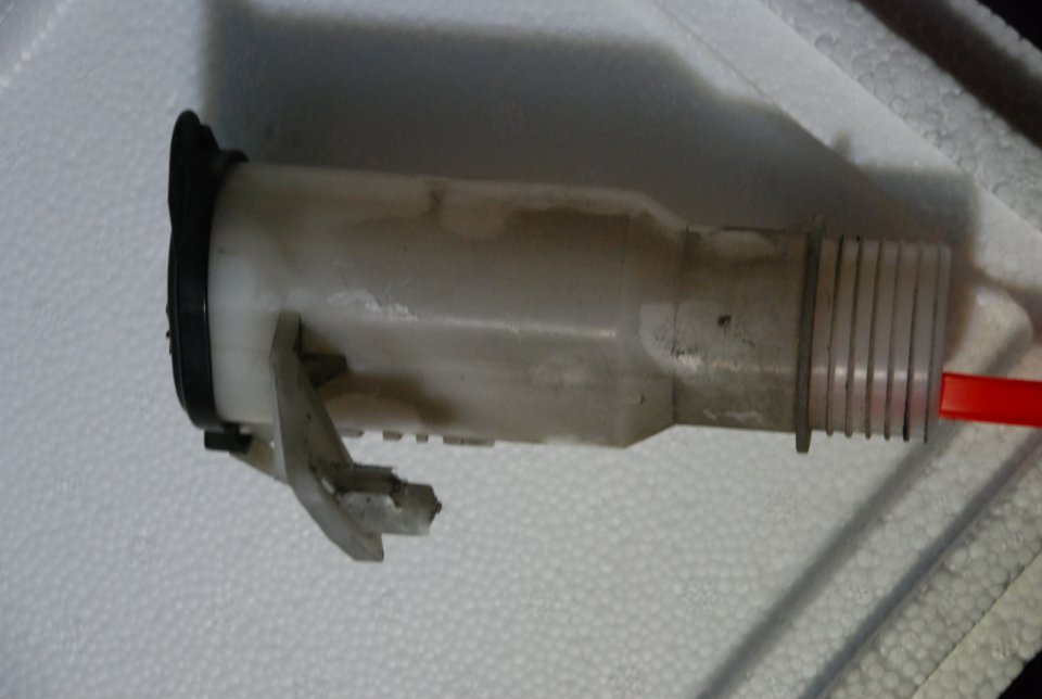

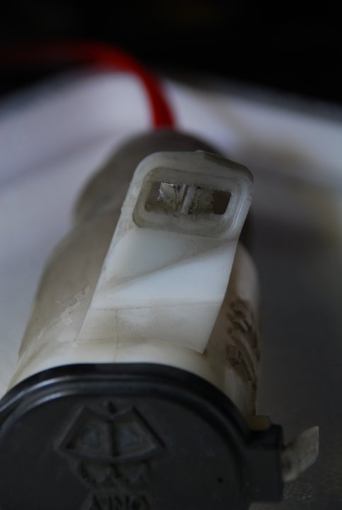

    I have a 2002 Prius (Gen I, I guess). The driver's side headlight burned out. I came to this site hoping to find out how to remove the windshield washer fill pipe, so I could access the light. I didn't find anything too helpful, so I just poked & pulled the white tabs. I firmly pushed a tiny flathead screwdriver next to them but I think that just ripped through the plastic at the bottom. Then I used needle nosed pliers to push the white tabs downward. That seemed to loosen things up a bit. I was able to pry the assembly upward with a regular flathead screwdriver. When the whole assembly came loose, the white tabs fell down in the engine compartment somewhere. So apparently I did break them off. They don't seem that important, the assembly stays in place fine without them. I think what I should have done was jam a tiny flathead screwdriver on the outside of each tab, then use a regular flathead screwdriver to pry it up. But it is probably just as easy to break off the tabs.
    Here are some photos after I took it out:
    slickrick11 likes this.

    As you say this does not seem to be any great problem. A couple of suitable size self taping screws down the square holes may help hold things without looking odd.
    John (Britprius)
