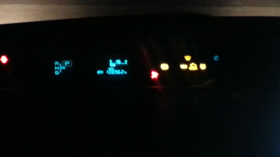

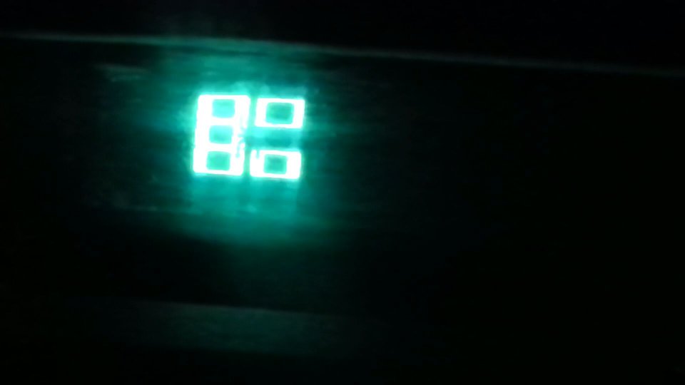

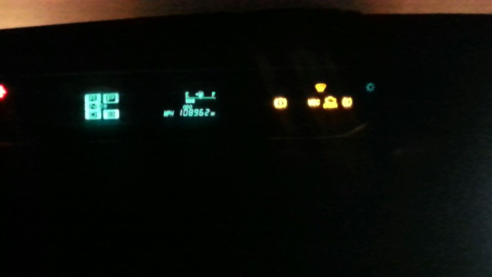

    Last night hit -21 degrees f where I'm at. Went to go to work this morning and my prius wouldn't start. All kinds of lights came on, but 'ready' never appeared, and the P, N, D, R, and B started flashing.
    I figured this probably isn't good.

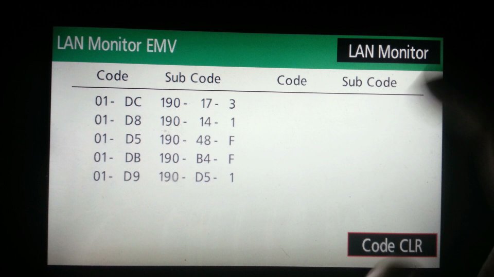

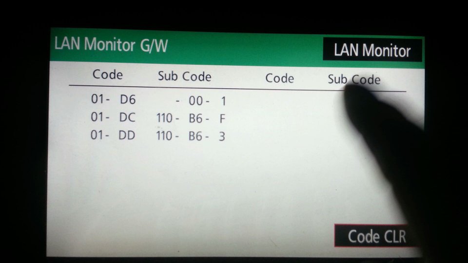

    Pulled these codes from the LAN Monitor in the MFD:
    01-DC 190-17-3
    01-D8 190-14-1
    01-D5 190-48-F
    01-DB 190-B4-F
    01-D9 190-D5-1
    01-D6 -00-1
    01-DC 110-B6-F
    01-DD 110-B6-3
    Is there a reference anywhere I can look these up? Maybe there's a pattern or something.

    Do you still have the original 12v battery? Maybe it doesn't have the power to start the car. I changed mine out recently and it was registering 11.5 volts I think. You should check your battery before panicking about something too expensive.

    Note that those LAN codes mean nothing. You can only get reliable codes read via one of the Prius specific code readers often mentioned here. But I agree, your 12V battery is very likely the problem. Put a charger on it. If you try to jump start, be very careful, absolutely certain, of the polarity.

    Not wanting to chance ruining any electronics, I took the battery out and put it on a trickle charge for 6 hours. Put it back in, and the car started right up no problem. Looks like I'm in the market for a new battery. Thanks everyone
