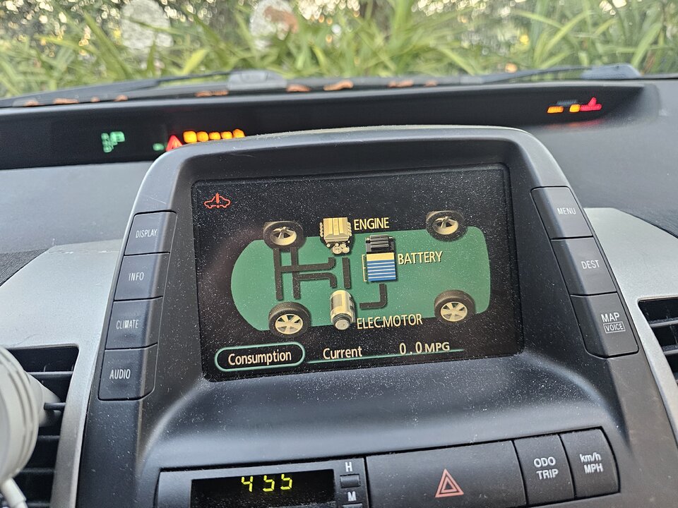

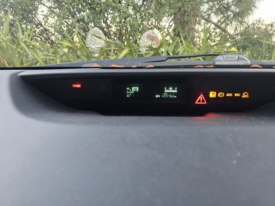

    I replaced my gen 2 prius with a new oem hybrid battery, and now it lights up but wont start. im pretty sure i did everything correctly but.. well idk.. the obd tool i use connected, but wouldnt read any codes.
    here is what the dash looks like.

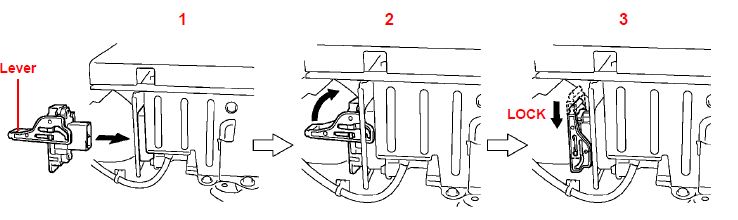

    What OBD tool do you use? Do you have power on the OBDII port's pin 16? Posting the codes you have would definitely help. For example, if you were to post you had P0A0D, we could advise you to check whether the service plug grip has been installed properly. Most people fail to complete step three, for some reason.

    I dont know exactly how the "clicks" sound, but i do hear some noise which could be interpreted as 2 clicks. However the car doesnt start/get into ready mode after that. On the screen it shoes the traction battery has 60% charged, which im not sure if its a current reading, cause the old battery was always purple.

    So you're saying you've slid the handle downward firmly until it clicked into the lock position? There is no wiggle?
    If so, have you tested the continuity of the leads going into and out of the switch that the service plug activates when in the locked position? The little connector there often gets forgotten. It's an easy thing to forget.

    genuinely apologize. it was exactly the orange service grip plug, i feel like and idiot. Car runs absolutely perfect and my OBDII reader wasn't reading codes, because there were ZERO codes.
    on the other hand, the reason me (and so many others) miss step 3 i believe is because in STEP 2, the part actually does CLICK and DOES move DOWN about half an inch... so I/we didn't realize it had to go down TWICE.
