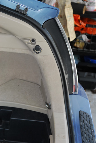

    The OEM cargo net (aka vertical cargo net) does require 2 plastic D-rings to be installed at the rear of the cargo compartment.
    There are 4 metal D-rings that come pre-installed in all Prii.
    If the second poster purchased a horizontal/flat net it will fit without additional hardware.
    The OP seems to have aquired a used vertical cargo net sans the installation hardware (plastic D-rings).
    I think your best option is to hit the hardware stores and see what you can find. I suspect the D-rings for the cargo net only come with the net...but it can't hurt to call or go by your Toyota dealer and ask at the parts dept.

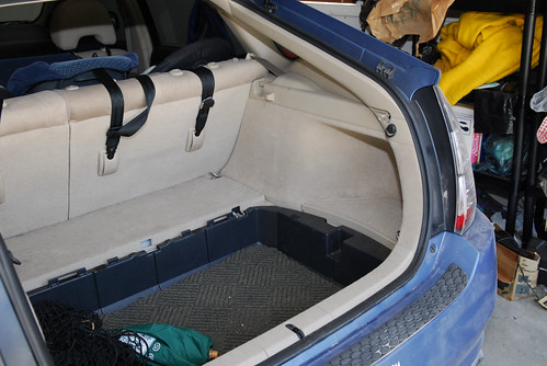

  5. efusco
    efusco Moderator Emeritus
    Nov 26, 2003
    19,891
    1,192
    Nixa, MO

    I would NOT pay $25 for this install...no way no how. It literally took less than 10 minutes including finding a drill bit and cleaning up. The actual drilling takes about 2 minutes if you're REALLY a freak about putting the template on exactly right and there's really no reason to worry about it that much. That entire area is safe, the plastic is soft, and if you put some tape on the drill bit there's no way you could go too deep....just use a slow drill speed and realize you only drill about 1mm deep.
    There's just nothing to damage here.

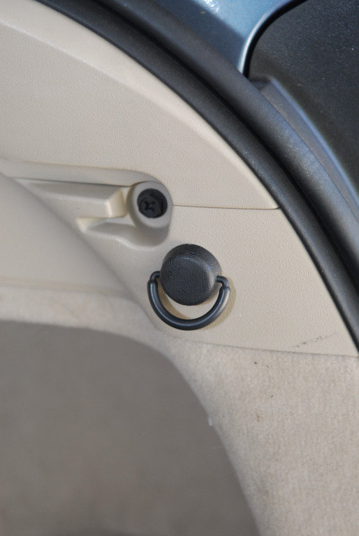

    I know this is an old thread, but WTH; here's some information I just posted on other threads but consolidate here:
    The hardware kit for the upper D-rings for mounting the cargo net in the Gen II is Toyota p/n PT347-47040-HK, available on line for around $5. Considering shipping, may be just as well to buy from your local dealer. I doubt the instructions will come with this kit, however -- they do come with the full net kit. If they can't be found on line, let me know and I'll scan them in.
    The rings can be removed after installation -- just "un-pop" the center piece that was popped in to mount it and they'll pull out. There's a little slot in the body of the part to allow you to slip in a small screwdriver to un-pop it. If you're selling a Gen II and want to keep the net, you might be able to find a plastic plug to pop into the holes.
    BTW, the instructions say to drill a "8mm (19/64") hole". Who's got a 19/64" drill bit lying around? Well, 8mm is actually 20.15/64, which closer to 5/16" than it is to 19/64". I had a 5/16" drill bit, so I used it. The ring pushed in with a nice firm fit, popped as expected, and feels very solid in place. I have the feeling that a real 8mm hole would be a little sloppy, but would try a 19/64" bit if I had the choice.
    So the question is -- did the engineers specify a 19/64" hole and the technical writers chose 8mm to comply with metrification, or did the engineers specify an 8mm hole and the tech writers chose the English size that was as small as possible and still allow the part to fit?
