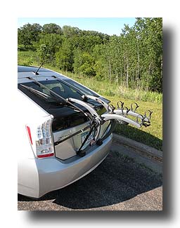

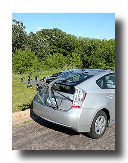

    Saris Bones has worked well for me...
    [​IMG] . [​IMG]
    Robo-driver likes this.
  12. gdbelden
    gdbelden Gator Hator
    May 29, 2008
    66
    63
    Virginia
    The Saris is what I use also. Works perfect!...
