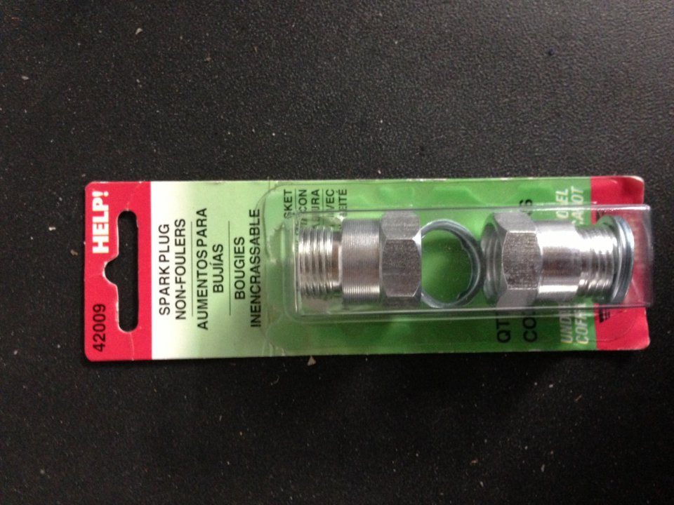

    Hi guys I just wanted to share my experience with my gen 1 and that pesky p0420 code or catalyst effiency code.this is getting more and more common as these cars age and buying a cat from Toyota will run around $1200 for the part alone and aftermarket cats are hit or miss and a lot of times require welding.this is something I used to do on my lancer evolution 8 (Awd turbo) when we removed the catayltics to install a test pipe for performance gains. My prius had the code P0420 catalyst effiency below threshold so I figured I would try it on my car since it would only cost me $5 and about a 30 minutes of my time. I'm happy to say that it's been about 300 miles so far and no check engine light!i checked the catalyst monitors via tech stream software and all are complete and pass!i just wanted to share the info and how to with my fellow gen 1 owners with stuff you can get from your local auto parts store.
    ****Disclaimer***** this may be not legal in your state as the catalytic converter is an emissions component and if you have a code for it chances are it has deteriated and not functioning as it should so it probably will not pass emissions testing. This is just to keep the ECM happy and to keep the light OFF!so if you have emissions testing with a sniffer you are going to have to replace your catayltic anyways sorry***
    What you will need:
    - Drill (Multi or high speed)
    - 1/2-inch Titanium Drill bit or bit used for drilling steel
    - 18mm Spark Plug Non-Foulers Part No. 42009 (they come in a pair from AutoZone for about $3.99 to 4.99)
    - 22mm or 7/8" wrench or Oxygen Sensor socket (7/8" deep well socket)
    - wd-40 or some kind of rust penetrate
    Step one
    You will need to grab one of those Spark Plug Non-Foulers you just bought.
    Take one of them and brace it against something solid, you will need to drill out the rest of the non-fouler in order for the Oxygen sensor to slide inside it (approx 1/2 inch).
    When drilling metal, it is best to take it slow. If able, borrow a multi-speed drill that you can control easily.
    Some kind of oil will need to be applied to the metal a few times during the drilling in order to provide lubrication, if you try to drill without oil, it will dull your drill bit very quickly.
    Step 2
    Once you've finished the drilling of the one spark plug non-fouler, you need to locate your second O2 sensor (usually right after the catalytic converter or the last one downstream on the exhaust pipe)
    Make sure you soak the o2 sensor with wd40 and give it at least 15 minutes to soak in before you try to break it loose.they usually crack loose and screw off with ease the rest of the way
    You can purchase a Oxygen Sensor socket (7.99 at AutoZone) this will make your life a lot easier.
    Step 3

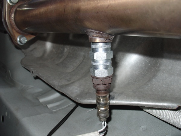

    Now you need to screw the de-fouler onto the oxygen sensor. You want to use the one you drilled out first and simply screw it on to the sensor then screw the o2 sensor and the drilled out defouler into the UNDRILLED defouler.then screw everything back into the exhaust where the original o2 went. Should look like the pic when it all said and done. It's easier to leave the o2 sensor plugged in to the car as the harness to disconnect it is inside under the carpet.remeber to always use jack stands when working under your car!! image.jpg
    Clear the code and you should be check engine light free!hope this helps some of you guys out image.jpg image.jpg

    Since the code is thrown when the second O{2} sensor shows no change with the first, the pipe may simply delay the gas exchange and mix it long and slow enough to 'spoof' the control computer that the catalytic converter is running. There is a phase change and reduction in amplitude so mixing fresh with stale gas would look to the sensor as if the catalytic converter had reduced the noxious gasses.
    IF I were doing the same thing, I would use a microprocessor to spoof the second O{2} sensor and 'have a happy.' In fact, I might as well spoof both sensors to run an extra lean mixture . . . even at high power settings. This of course would be totally illegal not to mention hazardous. Today we barely hear about carbon monoxide poisoning so we've become lax about the safety precautions.

    Made a 500 miles trip over the weekend,still no check engine light car prforms flawless.Even did it to my sister's first gen with the same code,she's also happy with the results :)

    I just did this last night on my 2005 Prius. It was extremely tight getting it all to fit in there, but I got it. Hopefully it keeps my CEL off.

    Tight fit on my 2007 as well. Got by the O2 sensor monitoring test without out the 0420 so I zoomed right over to the smog check place. Win.

    Installed the spark plug non-foulers onto my 2007 Prius downstream O2 sensor (212,500 miles) yesterday. Cleared P0420 code with my Techstream software, had helper drive car around while I observed live data while sitting in the passenger seat, worked great and after driving the car a couple hundred miles, all is good.
