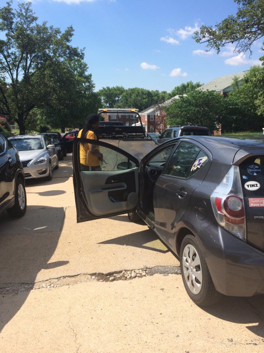

    I thought that those of you who own a Prius c, this "low maintenance" miracle car, would like to know what happened to me. I'm a courier. I drive 10,000 miles per month. When the c came out in 2012, I was excited to save money on gas, so I bought one. A three. I have loved and babied this car. I maintain it at Toyota, and in 2 years I have put 137,000 miles on my car. On Friday past, the transaxle failed. It just froze. They ran batteries of tests and sent the results to Toyota corporate, found no error in my maintenance of the vehicle- all they can tell me is that their part failed, and it's costing me $5,000 to replace it. When I bought this car, I expected to have to replace major parts in it rather quickly, because of the way I drive. But there's no way the transaxle should have failed so quickly, with no explanation. That's not the reliability I expected when I dropped $24,000 for a compact hatchback. Very disappointed. Even the service manager at the dealership said "it should not have failed at this mileage, with your maintainence record".
