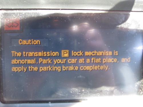

    I searched around and found information but it seems that there is no definitive answer as to why this warning comes up. My best guess was a bad 12v battery but mine tests out at 12.4, 12.2 with some items turned on, and 11.6 with headlights on.
    It started last year, only happed a few times and then started again this week. The car won't go into drive but will go into neutral. Power cycles don't seem to help much but it will eventually let you drive it. Seems very inconsistent so I can't pin down the cause.
    Has anyone figured this out? Thanks in advance for your help.

    I think that you have a real problem. The problem might be with the shift control actuator assembly, the transmission control ECU, or the parking lock mechanism. I suggest that you have your dealer diagnose the problem, as it may be covered under the powertrain or hybrid system warranty.

    how are you testing the battery?
    i've only seen this happen when the 12v gets low and other times i just turned
    the car off a second time and it went away
    before spending too much, maybe you can get a good load test on the battery
    reading the battery voltage isn't as good as an actual load test

    Your 2004 transaxle has an electric motor operated parking 'paw', a mechanical lock that freezes the front wheel. If it fails to engage, the transmission remains in "N" when the car is turned off and can easily roll away.
    The error message is telling you to always use the "parking brake" to hold the rear wheels fixed and try to use a flat place so they will not "give" and the car drift away.
    This is a safety feature and should be fixed soon. Unfortunately, it is unlikely to be 'cheap' given where it is located. ... bummer ...
    If you are very, very lucky, a connector has come loose and the electric driven parking paw won't have to be replaced. This is lucky in congratulations on winning the lottery.

    like ive said, the battery should be load tested first. ive had that exact message on my car at least 7 times since ive gotten it, and its always been because i had the car in accessories too long, like 45-60 minutes of the radio will cause the parking warning
    to come on, and the battery was still good enough to get the car started
    reading your voltage of the diagnostic screen is not the same as an actual load test
    and that is physically removing the battery and connecting it to the tester
    a battery can have one or several weak cells but still read normal voltage on the mfd
    also on more then one occasion i've gotten that message to come up, just by
    maybe turning the car from ready to off a little fast ( i think )
    also worth noting is this is my second 12 v battery and i only have 35,000 miles on the car.
    toyota dealerships do not physically remove the 12 volt battery and check it for load
    when you have the car checked, unless you scream at the service advisor for 10 minutes!
    i would use the parking brake, like other people say, but if it comes on more then once or twice in a row or if it happens regulary, oh yeah tow the car and have it checked

    if you sit with the car in ig-on/neutral for a while it might do this. DH saw this message on the occasional prius after an alignment, where it sits on the rack in ig-on and neutral.
    the other time he saw it, it turned out to be a faulty park lock actuator.

    thanks for all the input. I'll post again when i have news but it hasn't happened again. I'll go get a load test done but I'm unwilling to take it to the dealer until it leaves me stranded.

    Let's see... You have a 4 year old battery and a condition that is known to come up with a weak battery. I'd just replace that battery because it's worn out. All sorts of weird things start to happen when computers don't get the juice they need. This is just the first one you've run into.
    Get an Optima yellow top, plus the conversion. It's a better battery for about the same price as the original.
