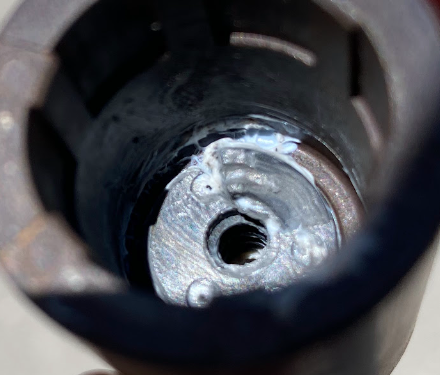

    The EGR valve may need replacement, if there’s a groove worn like this:
    this is looking at the interior of the cap that’s inside the EGR valve.

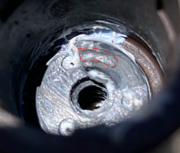

  4. ChapmanF
    26,235
    17,182
    In case it's not clear what groove Mendel meant in that photo, here's a photo with the "ski jump" undamaged on the left, while the one on the right has a rut worn through it,
    ToyotaCoyotta and Mendel Leisk like this.
  5. Mendel Leisk
    Mendel Leisk Senior Member
    58,751
    40,457
    Yet another:

    If you can see the rut there, you have ocular proof the valve isn't working.
    That stop is what keeps the rotor from going past the valve-closed position. The rut gets formed a little at a time by the rotor going a little too far and plowing out a little of the plastic. Next time it can go further (because there's already a bit of a rut) and make more of a rut.
    By the time it's plowed all the way through like in that photo, the rotor goes right on past the whole valve-closed position and doesn't stop turning 'til it's tight down on the threads. A poster in another thread figured that was about 120° too far.
    That other thread also tried to determine the number of steps per rotor revolution, and ended up guessing 48. If that guess is right, then 120° is sixteen steps on the wrong side of valve-closed.
    If you are testing the EGR with scan tool active tests where you say how many steps to open, normally by step 16 you're getting pretty close to killing the idle. On a rutted valve 16 steps might not even have started to open it yet.
