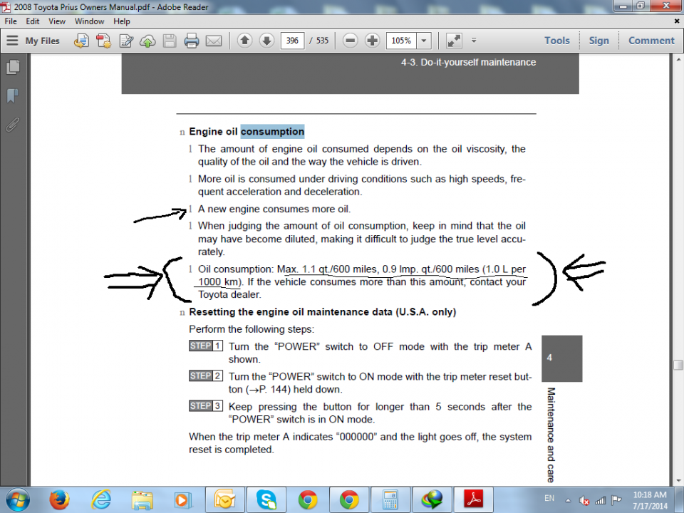

    ok but the consumption is very high since for the interval of 3000 km the car just have 1.5 litter of oil !!!
    and regarding the manual as attached picture this situation is normal !!
    am just adding 1 litter each 2000 km to keep the level of oil within the range !
    my car is Prius 2008-6 with 120000 Km from Europe

    Your engine was damaged by its prior owner, apparently - and changing the engine oil every 3,000 km is not going to help it to get better.
