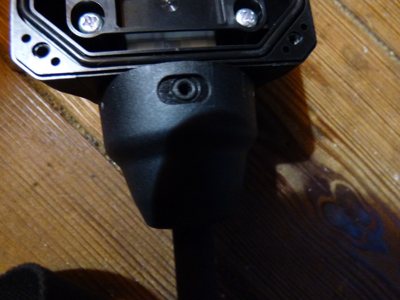

    No...the twisting/bending stopped working this morning. I can no longer get any kind of connection. I opened up the back but you can't really see anything of the incoming wires. It looks like you need some kind of special tool to remove the 'caps' on the ends to inspect the wire/cable.

    Actually those caps on both ends just screw off (left to loosen, right to tighten). You'll see two flattened portion on each cap where you can use a pliers or vice-grip to get a solid grip...then just unscrew.

    Mine has slots for a special tool in the caps.
    I'll see if I can figure out a way to get it off and take a pic of the connections
