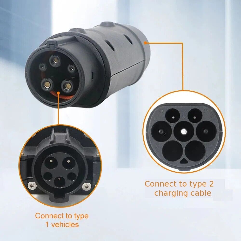

    I can finally see the pics you attached to your OP,
    so when you took the second pic you were charging at Type 1 120 volts, yes?
    I remember with my 2014 Plug-in that Type 2 220 volt charging took about 2 hours to fully charge the battery form 0% EV / State Of Charge to 100% SOC.

    The Type 2 to Type 1 adapter is just a very simple rewire hub. Nothing to do with the voltage change. So the second pic in the #1 post is using 230V to charge.
