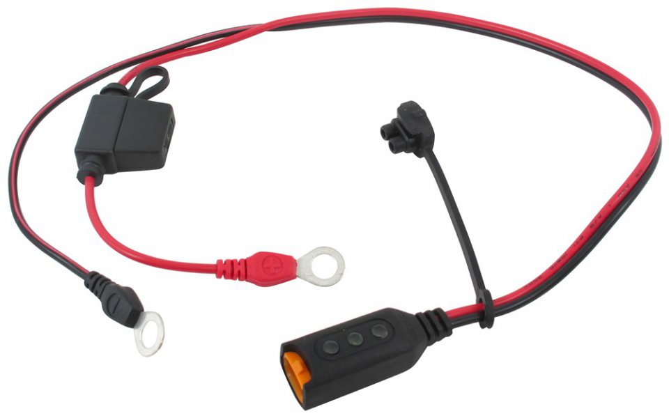

    As fitted to the summer-only sports car, CTEK makes a quick-connect plug that can be hard-wired to the battery via ring connectors. They also make a quick-connect with LED battery condition indicator. On the Prius, the ring connectors could be wired to the 12V battery with the quick-connector left exposed in the cargo compartment or beneath the rear seat for easy access and use.

    As a precaution, having only had the car for a couple of weeks and with winter here, I have got rid of the old 12volt battery. It's been replaced with a new Bosch that has a 4 yr guarantee. I have also attached the CTEK eylets direct to the terminals and left the connector (which is capped off) poking up from the compartment ready for the charger just in case it's needed. Another precaution, I am getting more paranoid in my old age!!
