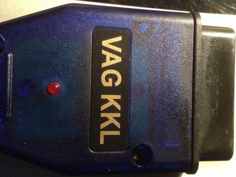

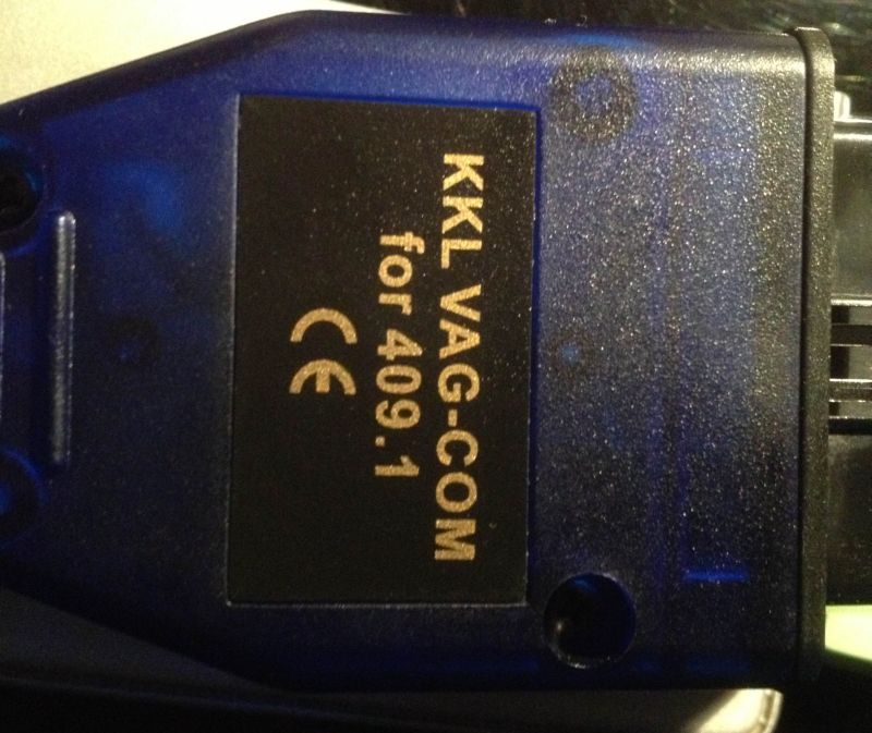

    Here are the pics of my cable:
    imgur: the simple image sharer
    Just scanned my HV battery. All the cells are in good condition. What a relief. All credit goes to Rubixcom
