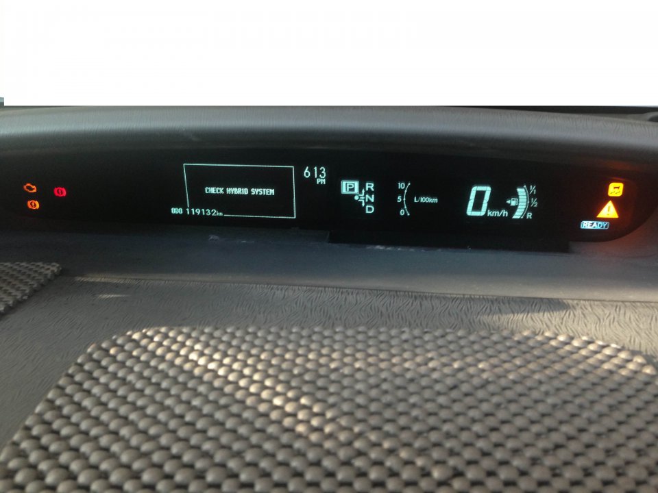

    Hi folks ,
    What does this ' CHECK HYBRID SYSTEM' flash means? As per enclosure/pix.
    ODO reading is 119132km.
    Car is fully serviced and maintained according to schedule . Original batteries are still in used. Nothing has been changed except the tyres and the air conditioning refrigerant recharge.The car is 4.5 years old . Driven as a personal car with a daily commute of about 60-100km.
    Is the traction battery failing before the 12V battery ?
    The lead batteries shows about 12V (perhaps less, inaccuracies due to the 0- 50 Voltmeter calibration ) .The toyota folks resetted the computer system without providing the error codes. Car operates as usual now but I don' t trust the dealer . The dealers ask us to bring the car back should the flash warning reappears.
    Kindly advise.
    Thanks
  7. CARspec
    CARspec Junior Member
    Sep 30, 2014
    53
    Eden Prairie, MN
    2014 Prius Plug-in
    "Check hybrid system" just means you have powertrain codes related to the hybrid system. These can be misfires that leads to poor performance codes and the like - it doesn't mean anything specific other than, "I've detected a malfunction and now here's some lights to bug you". You'll have to pull the code and sub code to really get a meaning, then begin diagnosis.
  8. GrumpyCabbie
    GrumpyCabbie Senior Member
    Dec 14, 2009
    6,722
    2,121
    45
    North Yorkshire, UK
    Leave the car overnight and THEN check the 12v readings. Your car is at the ideal age for the 12v to fail (usually they last 5 years/80k miles). It's a cheap fix and there are literally hundreds of similar threads on this forum.
    So check the 12v after the car has been sat and let us all know your findings.
