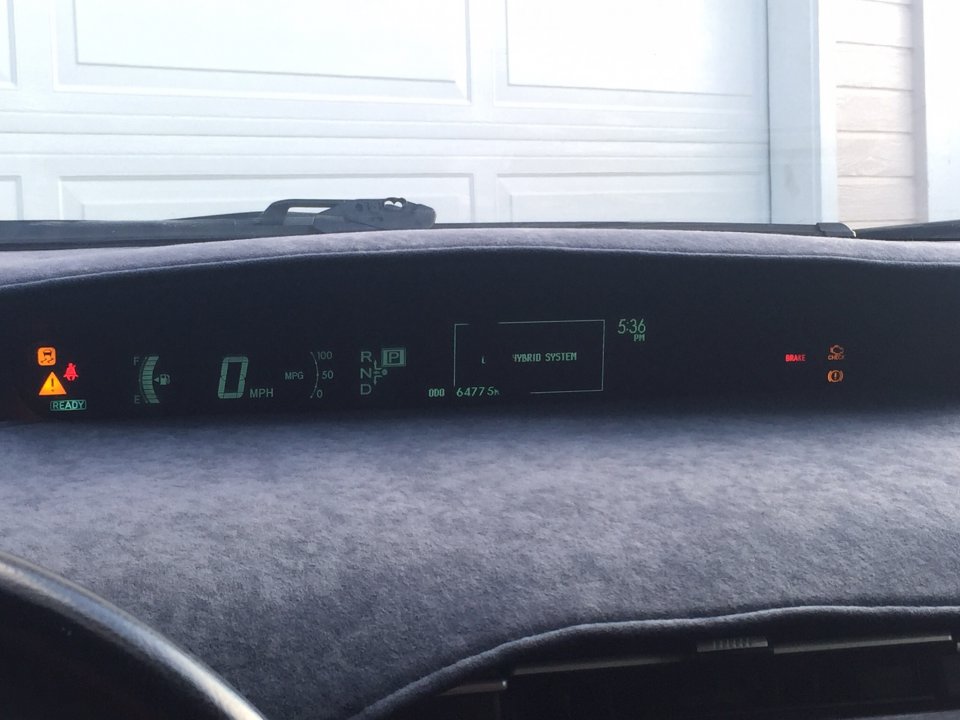

    Ok so I have a 2010 Prius 5 and before I took it into service the car started acting weird. At slow speeds it would be in like ev mode and wen I would push on the throttle it would kinda lag n almost feel like the car was gonna die out but it didn't. It would only happen once in awhile. When I took it in for service at Toyota I mentioned the problem n they couldn't find anything wrong. So a few days later I was leaving Costco and as I got bout 10 feet away from the stall I was in the car did that same almost die out thing but the car started beeping and all the lights on the dash came on with the check hybrid system. Every light was on n stayed on tpms, traction control light ect. The car still ran but it ran like shit n the engine stay running the whole time.I managed to get home safely and took it into Toyota on a stand by appointment the next day. 3 days later they call saying the car is ready to pick up n the problem was the hybrid battery (240volt) was no good n was coverd under the hybrid side of the warranty which is 8 years/180,000miles. Anybody else ran into this problem yet oh n btw the car has 64,000 miles I maintain the car very well I did all fluid flushes at 50,000miles. this was the first problem I ever had with the car. image.jpg

    I'm having the same exact problem with my 2010 Prius. Suddenly all the lights came on plus "Check hybrid system" today. It drives a little bit sluggishly. Unfortunately I just passed the 8-year warranty period a few months ago but have less than 100,000 miles. Toyota dealership will do a diagnostic test in a couple of days. When I called Toyota headquarters today they opened up a case number and asked me to call them back with the results. If it does need a new battery I don't expect them to come through. Anything else this could be besides the battery? The Toyota dealership acted like it could be dozens of things.

    The car has trouble codes that can be read by the dealer software and some other scanners. Other trouble scanners only read the basic codes, not the hybrid specific ones.
    The lights are just to alert you that there are active trouble codes. The codes (and freeze frame data, if any) dictate the troubleshooting path.

    It can be different things.
    For ~$75 you can buy your own tools to read and scan codes as well as see live data like battery voltage.
    - Android phone/tablet
    - Elm 327 Bluetooth OBDII reader
    - Torque Pro app
    I feel like all owners of older Prius should automatically be issued these things once the cars reach a certain age. Would really help when trying to diagnose inevitable problems that arise.

    Perhaps because this is true? The "CHECK HBYRID SYSTEM" warning will come on for everything under the sun. In your shoes, I would get the dealership to check the codes, go from there. Be sure to get the codes from them, post here.

    I have 2010 Prius. Check Hybrid system light came on for the 1st time last July, scared the heck out of me as I had no idea what that meant. My mechanic and then the Toyota dealer both said I need a new battery, about $4000 dollars. I already had 195k miles so I wasn’t sure I would want to spend that kinda money. I got a OBD2 scanner from amazon and turned off the warning light and decide to just drive until the battery completely died and then I would just junk it. Well, I’m at 208k miles now and the car is still driving very well. My mpg has gone down to 48mpg from 53 ish, however.
