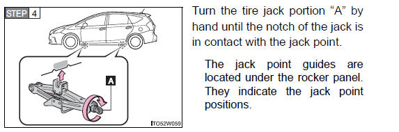

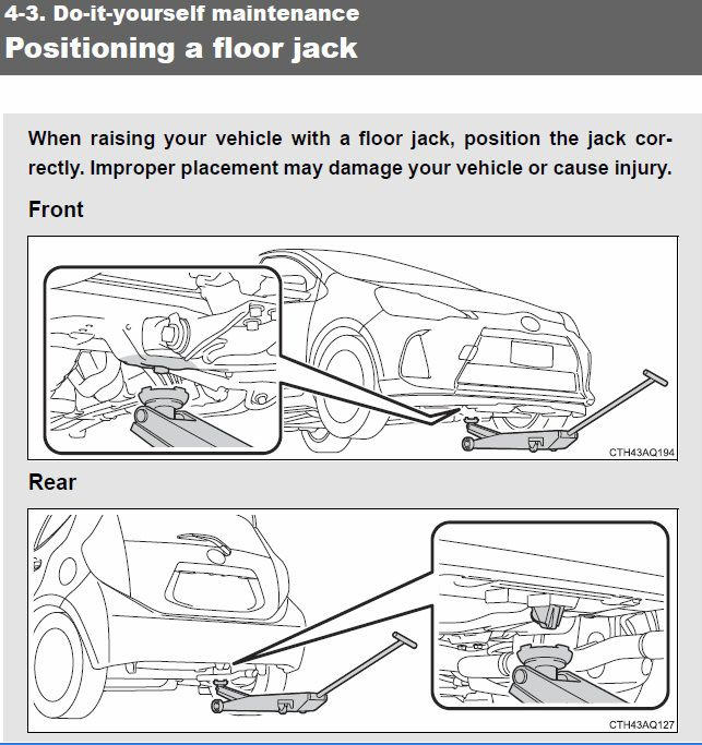

    I would take it to a neighborhood oil change place and have them check it. Probably the worse that is likely are the plastic covers under the engine could be loose or might be missing altogether. If they are loose, I would want them resecured before I lost them. As far as the jack points, use them exactly as in the manual. There is a front center jack point under the engine in addition to the sides. But really, just take it in to one of those drive through oil change places (no jacking needed) and have them look. Probably for free. Then later to the dealer for another free inspection but there you will wait.
    Floor jack adapter for side rails:
    http://www.autoparts2020.com/rsdev/part_detail.jsp?PART_HDR_ID=102279

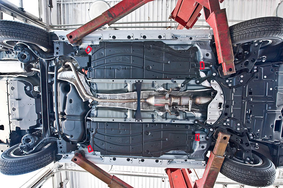

  5. Mendel Leisk
    55,587
    38,741
    These are the points I'm using now, on our 3rd gen hatchback. Don't know how they'd translate to the V, but fwiw:
    The front points (right side) are at the leading edge of a rectangular rail.
    The rear points are a reinforced zone, just ahead of rubber plugs filling a slot opening. Those plugs are put in at the dealership, my understanding from their parts department was that the slots were for some sort of locator pin, used in transit. For both the front and rear points the steel is reinforced, thick.
    I concur the official jacking points are not suited for regular jackstand bearing. If you look at the shape of the supplied scissor jack, it becomes clear what shape is needed. And, I've used the scissor jack once with a flat, and found that single use caused a bit of punch in, and that was on a rear wheel, less load.

    The Gas tank
    Thanks for that image. But I have two questions. One, what function do those two black covers between the axles (left and right of the exhaust pipe) serve? And two, but is the fuel tank made out of plastic? I'm not too worried about plywood damaging the drive axles or brake lines, but I'd at least like to avoid future rust from road salt and rainwater, and not have to go through a fuel tank replacement.

  9. Mendel Leisk
    55,587
    38,741
    The covers are primarily for aerodynamics. I believe there's hybrid battery cables enclosed as well, so they offer some protection for those as well.
    I think the tank is plastic, you should be able to reach it with a hand, even without raising the car. Rap it, see how it sounds/feels.
