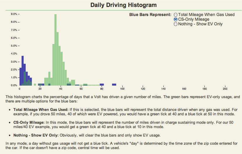

    I track my data by hand as well as using voltstats.net.
    My "green" energy is from my elecric co-op, which has its own solar and wind units and when that is not enough they buy green energy from Tri-state Electrics. My co-op owns no generation except green, so they have no incentive to provide anything other than what I pay for. Colorado law requires green credits to match those purchased. For a while I was buying pure wind, after discussions with my co-op who was moving away from just blocks of wind and my own desire about putting in my own solar and such I realized I wanted to encourage both so moved to general green energy blocks (so it can be wind or solar). Our coop has both now and are buying the solar from community members now and hopefully this will be encouraging growth of the install base. I'm getting quotes for my own solar but will still be buying the wind because we are wasting it. In 2010 the US Idled (i.e. wasted) 25TW of wind power.. mostly at night. That is we just "turned off" the generators to to about the energy of 700million gallons of gas. So even if I go solar, I'll keep buying the wind too.
    My off peak KW charge (including the green energy surcharge) is .052 and my mid-peak is .093 (rates recently went up.. was .049 and .090 for much of the time in my signature). I am on time-of-day use metering.. off peas 10:30-5:30. midpeadk 5:30-noon, off peak noon-4pm, peak 4pm-10:30pm. I charge mostly at night, I don't have it start charging until 10:30 (when off-peak starts here) and it finished between 5:30 and 7:30 depending on how far I went the previous day. I brought home a kill-o-watt meter from work when i started getting into measuring stuff and measured my wall-to-charge which is part of how I track the costs. I computed an average cost-per kWh for a full charge and use that in my spreadsheets.
    My commute is 35miles "shortest days" and with errands, lunch or other trips generally 42-48miles. Here is a histogram of my daily driving, green shows EV miles, blue is ICE miles
    Some days I (generally unexpected) have longer work-realted side trips taking me to 60 (ICE of 0-20 miles). Trips to denver or the airport are > 100 and when I use gas most offten (> 20 miles ICE).
