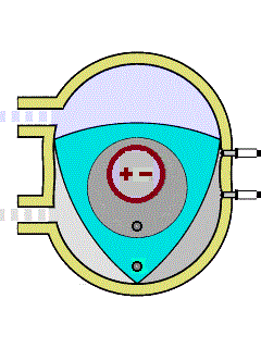

    Horrible article; innovation is basically combining Wankel with electric motor is one package.
    Granted there are Wankel Atkinson cycle geometries, but kinda doubtful given the thermal losses, efficiency and environmental issues. Maybe Mazda would build one

    Mazda has clearly demonstrated over years and years now that rotary engines suck (guzzle oil, terrible fuel economy, terrible longevity). Perhaps in this application they wouldn't, but it would be a first.

    This is basically how a motorcycle engine provides an alternator. The crankshaft is the rotor, and the stator is mounted on the crankcase. How is this any different? Except it is a less efficient engine?
    Why not just turn an old turbo into an alternator? Just put it downstream near the tailpipe. Still, there is back pressure, but your fuel is already burnt instead of providing new fuel. Just a thought.

    The battery comparison is because the device can be made very small, which would allow it to power some of the same devices traditionally powered by batteries.
    A better title for the article would have been: "Tiny internal combustion engine targets traditional battery applications."
    It isn't a battery. It doesn't have anything to do with batteries. It *is* small, and it generates electricity. That is the end of the similarities.
    This device would be entirely unsuitable for hybrid vehicles. In fact, rather than use this, one can use the engine already installed under the hood. Batteries are used in hybrid vehicles because they can store energy. This tiny motor can't do that.

    This device *is* an ICE. Therefor it won't help for ICE downsizing, ICE off coasting, or anything else ICE. It's just another motor-generator, albeit a very small one. It won't be small if you scale it up to the size needed for a car. Then it will be essentially a Mazda powered Prius.
