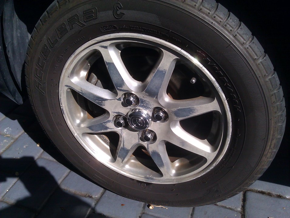

    Anyone else having this issue?
    Here is a picture:
    Been noticing that some of the clear is coming off the wheels when I was washing the car the other day. Not sure if previous owner had possibly applied some chemical or if this is normal for a 10yr+ old car.
    Called a couple wheel re-finishers and they mentioned anywhere from 60-99 to fix each wheel.
    Is there a DIY method?

    Yes, mine is totally gone or nearly gone. I have had to recondition 2 wheels and the other two are in desparate need of it as well.
    The DIY method is very simple. Get some "outdoor" or automotive clearcoat, remove the wheel from the car, remove the centercap, lightly scuff (400 grit wetordry) the wheels and feather any rough edges, mask off the tire and spray the wheel with the clearcoat per the manufacturer's recommendations. I would do at least 2 coats if not 3.

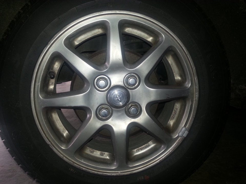

    Here is a pic of one of the wheels I did. It is holding up well after about 2 years. 20140108_155956.jpg
