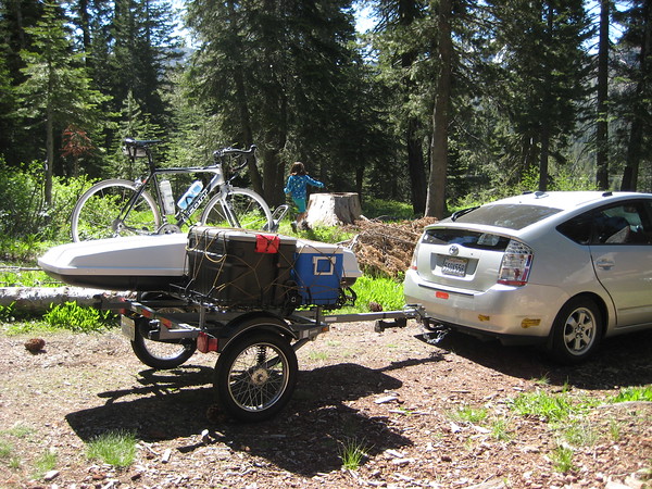

    I may not have tried the *most* different racks on my Prius, but I did buy and use several before ending up with the permanent solution.
    Let me just point you to my pages if you haven't seen them already:
    Prius Racks (clips)
    Permanent Rack Pads
    I go with Yakima just because it is a (more) domestic product, and I've been using their stuff forever. All my stuff is capatible with all the other stuff. I like round bars more than square - especially on a car like the Prius with a highly arched roof. And if it isn't yet obvious, my choice is the permanent rack mounts. Suddenly using racks is easier then unlocking the door. Having to line up the clip-ons is a huge turn-off.
    To answer you mileage question, please allow me to be blunt:
    I hear this worry all the time, and don't understand it. What are you going to do about it? Leave your boats or gear behind because you never want your car to get 35 mpg? Don't fret about it. Your mileage will suffer as long as the rack and gear is up there. The worst you'll do is better than the best SUV can do empty. The other times with the rack off the car, you still get the 55 mpg. Just turn off the MFD while hauling gear.
    I just drove this rig up 7,200 feet. Car and trailer fully loaded with food and camping gear for 16 people.... plus my bike! 32 mph up the hill, 65 mpg down the hill. I'm not going to cry.

    You betcha. They offer three different lengths. I have the middle one. Here is the longest - the other two options are below it:
    Tongue Extension C
    You can carry a 23.5 foot item with this, provided it is mounted in the middle.

    Read all about my hitch experience here:
    Prius Hitch
    And probably my mods page can answer many questions. Has more on the trailer, wiring, etc.
    Prius Mods
    I've had zero problems with the hitch, the trailer or the car. No problem up hill, down hill or with brakes - provided you drive it like you're towing a trailer and not like you haven't a care in the world - like I see most trailers being towed. (long enough sentence??)
    Quite simply, there are no problems, and I love having the option of the trailer on every big trip. Do I take the tandem and the cargo box and firewood? Or do I take the mountain bike and the kayak?
