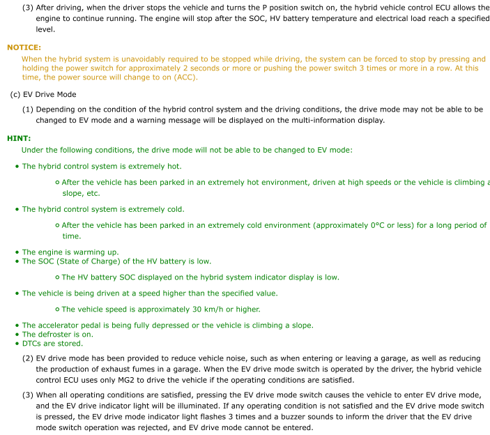

    There are sensors for the temperature for MG1, MG2, Inverter and Hybrid battery, as well as the battery intake air temperature.
    TOYOTA have advised:
    Harters and Mendel Leisk like this.
