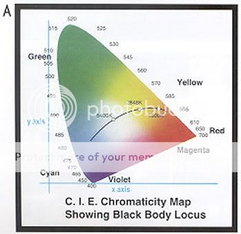

    Usually the exact colour is determined by the states individually, but is also generally set at 4300K universally. Also it is sort of Federally mandated...
    The feds require each projector and reflector and combination thereof in a full assembly to be tested with a specific bulb. This bulb is what they use to make sure the lumen output is sufficient along with aiming, and patterns, and crash testing and so on. The federal requires go on to say that only bulbs that have been tested in the housing are legal to be used when replacing the bulb. Since the OEMs all use 4300k when testing, the only legal replacement bulb is a 4300k bulb.
    If your goal is to see deer, then you want more light, not less. The higher the Kelvin rating, the lower the luminous output, not more... Notice how 4300K is in the best place, the "sweet spot" as it is known, and also why it is standard.
