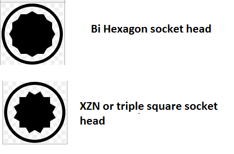

  9. Mendel Leisk
    60,856
    41,893
    Gasket Masters mentions triple square: it works but is not the optimum; Toyota specs a double hex bit (same number of points, but 60 degree instead of 90), and slightly different dims.
    the proper bit is available on Amazon; I just never remember to look up and bookmark.

  10. TAPnAR
    TAPnAR Member
    Nov 19, 2019
    37
    36
    Fayetteville, AR
    Thanks for the info, I will definitely get one the next time.

  12. TAPnAR
    TAPnAR Member
    Nov 19, 2019
    37
    36
    Fayetteville, AR
    I did not damage the tool, but I will get the proper one next time if I have to do it again.
    Here is a pic of the difference I can see where that might be a problem. Bi-hex is what Toyota specs.
