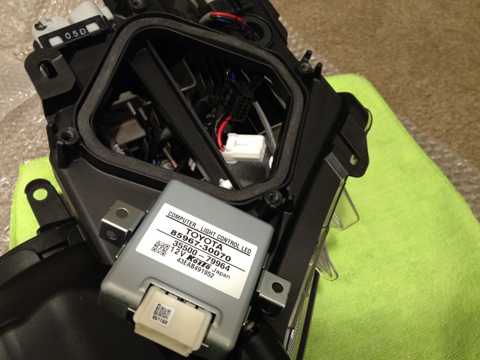

    Last week I went to my local Toyota Parts department and ordered the Computer, Light Control LED modules and eight screws. I open the package and the modules are very tiny and are Part #85967-30070. Please see the picture below to show that I definitely received the wrong part for my headlights.
    What is the exact part number for the 2010 headlights that I have? Do I need to order the Part #85967-47010? What is Part #85967-30070? Is it for the 2012 - 2015 Prius?
    I need to return these and get the correct part for the 2010 LED headlights. I would like some clarification.

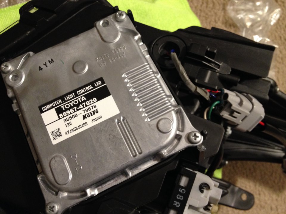

    Issue resolved.
    Apparently, there is a difference with the Computer, Light Control LED unit between 2010 - 2011 (Part #85967-47020) and 2012 - 2015 (Part #85967-30070) headlights. The 2010 - 2011 unit is larger and heavier. I returned the one for the 2012 - 2015 and received the 2010 - 2011.
    I hope this information could help someone in the future.
