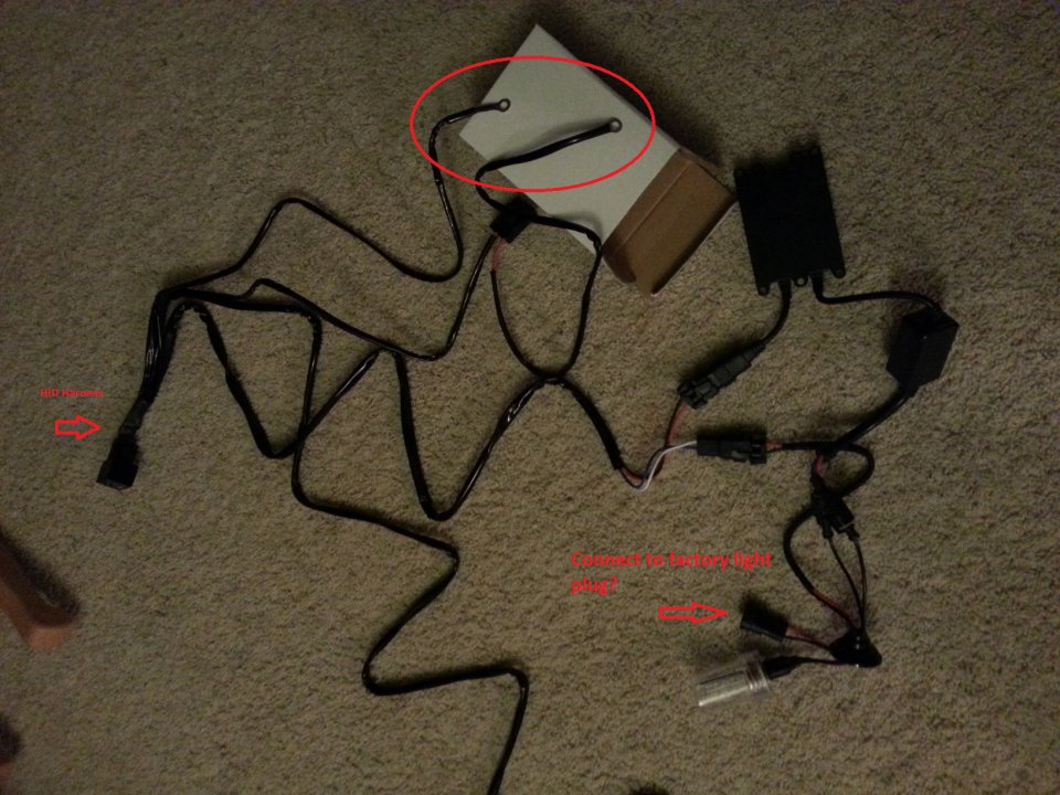

    I was laying out my HID's and just making sure everything was there and everything went together but i was a little confused about two wires. I got the DDM Tuning 55w with the HID Harness.
    Coming off the harness there are two little eye-let connectors that i assume get connected to a power source? Also i have an arrow and the question does that plug get plugged into the factory light plug?
    Can someone help me out?
    Thank you

    I think you can leave all the stuff to the left out. My DDM kit only comes with ballast bulb and small harness. I would try to power it up. Looks like your kit may have come with an extra relay or those anti flicker modules.

    yeah thats what they told me the HID Harness is for, to prevent flickering.. they are the 55w ones not the standard 35w so im not sure if i need it or not.

    Your HID harness/relay should have 3 connections, power, ground, and signal. Power comes from the fuse box or battery, ground goes under an unpainted bolt on the chassis, and the signal connection is the driver's side headlight factory connector.
    You have the connections wrong in your pic. The connections from the HID harness wire should be male connector (the one with the pins) goes to the factory lowbeam connector on the driver's side. The female connector goes to the short connector on the HID bulb, which is usually connected to the oem lowbeam connector in a non-harness setup.
    The long connector coming off the HID bulb always goes to the ballast, that's where the HIDs get their power. You have the long connector going to the relay harness in your pic.

    thanks xliderider... question is do i 'need' the harness or will they work just using the ballast and bulb?

    Since you have the relay harness use it. It will provide a more reliable power supply source than the factory lowbeam circuit wiring.
    Many will tell you that the HIDs work just fine without the harness, but the suppliers and manufacturers all recommend using a relay harness.

    I am looking at the connections again and going over what you said and either I have the wrong harness/bulbs or you made a typo bc the way I have it set up in the picture is the only way it will all go together. The problem I am having is with the female connector from the harness connecting to the shorter male connector on the bulb.. the males pins are close together and the female side are wide so they dont go together.

    Ah, the narrow spaced pins are H11 and the wide spaced ones are 9005, like we have on the highbeam bulb.
    You might need to wire the HIDs without the relay. Then contact the seller and get an H11 compatible relay harness.

    In that case, installing without the harness, it should go like the following..
    factory plug to ballast then the two small plugs from the ballast to HID bulb and that's it.. correct?

    No. The factory connector goes to the short wire on the HID bulb, as labelled in your pic. The long connector goes to the ballast. And then the two small connectors from the HID bulb are also connected to the corresponding ones from the ballast. There should be no unused connectors.
    Think of it this way, the long wires have to be the same length coming, and going to the ballast (all 3).

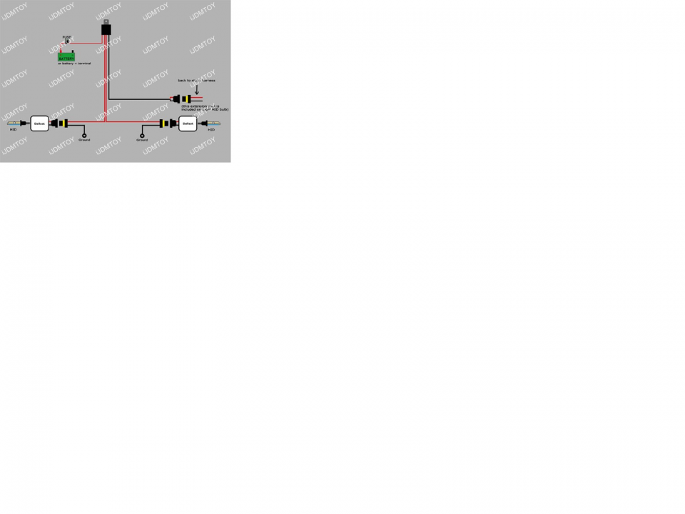

    On the other hand i am still struggling with how to connect everything including the HID Harness...
    They way Xliderider explained in an above post just doesn't make sense to me. i would think the factory plug would need to plug into the HID harness somehow to send the signal to turn on and draw the needed power. I still feel that i need to plug the factory plug into the one i have an arrow by with the question in my first post.
    I really wish there was a diagram provided from DDM Tunning... would be real helpful!!
    Maybe someone on here can do a quick one?
    thanks all!

  16. CdotK

    perfect... now that makes sense!
    thank you!
    Here are the pic for people looking for help as well.
