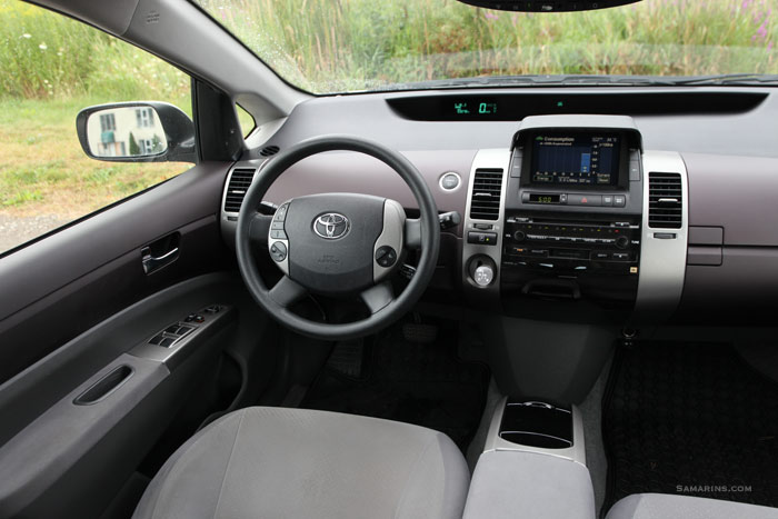

    @paprius4030 gave good advice. A fleet-registered car should cost less because it has the fewest features. Also, I'd double check the car and the year. 2nd generation Prius goes from 2004-2009 and the interior looks like this:
    and a 3rd generation Prius is model year 2010-2015 and the interior looks like this:
    If the car you're looking at is a 2nd gen Prius, then it is not a 2013 and someone is trying to lie to you.
