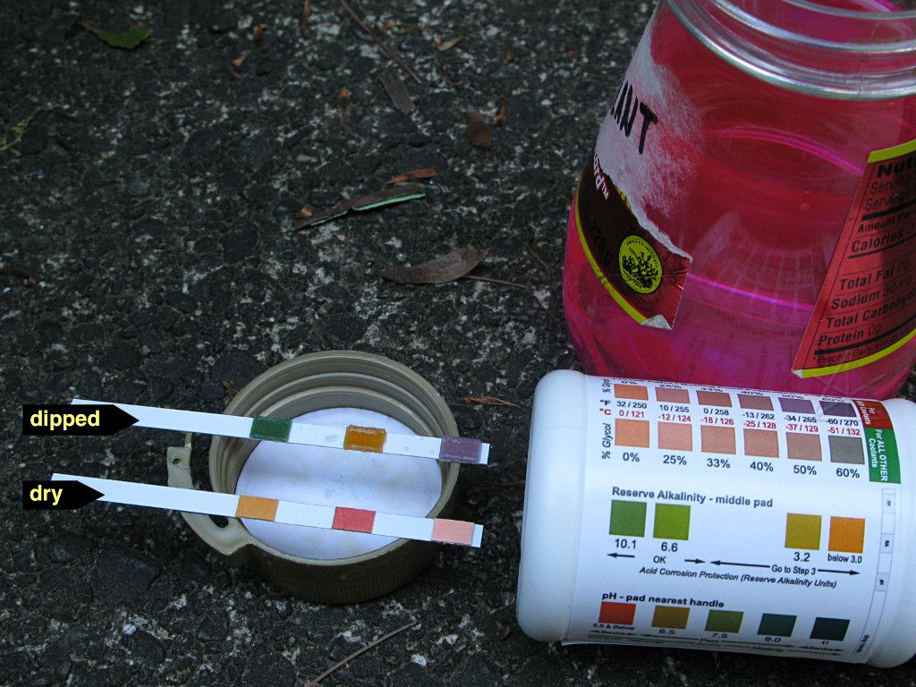

    Mike, I posted Hobbit's inquiry earlier, but here is his pH check of new SLLC:
    No doubt that the new coolant is alkaline, around a pH of 9.0. I find it interesting though that SLLC has relatively little buffer.

    The strip that Hobbit used is made specifically to test car coolant. Believe it. Also, note that the strip has a reaction for 'reserve alkalinity' so the expectation is to find acid buffers.
    As for the chemistry of the reaction, I am not sure but it looks like so called 'universal indicator' by the color scheme. Those with too much time on their hands or insatiable curiosity can read the Wikipedia monograph.
    Tomorrow I'll check the pH of new Asian Zerex, 2 year old SLLC in my car, and some OJ with urine dipsticks my wife kindly supplied. I like the idea of trending these measurements.
    Back to OP: Per Hobbit's tests, if your coolant pH < 7.0, it is time to replace. It might be time anyway -- I am only mentioning one characteristic of old coolant.

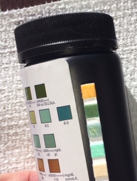

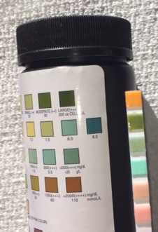

    As promised, pH testing:
    1. Coolant from Inverter Reservoir, ~ 50k miles use
    2. New Asian Zerex Coolant
    3. Ruby Red Grape-fruit Juice
    The strips are "URS-6L," made by teco diagnostics as a urine dipstick. The pH test is the second from the top and ranges from pH 5.0 on the far left to pH 8.5 on the far right. The test relies on color change of bromothymol blue and methyl red to pH. This is a variant of the 'universal indicator' method.
    Conclusions:
    1. Ruby Red Grapefruit juice is safe to drink, at least pH wise. The color change took time, so we are not reading the color of the juice. The strip appears to be working.
    2. New Asian Zerex Coolant is alkaline
    3. Used SLLC is slightly alkaline. Time to replace ? I think so.
