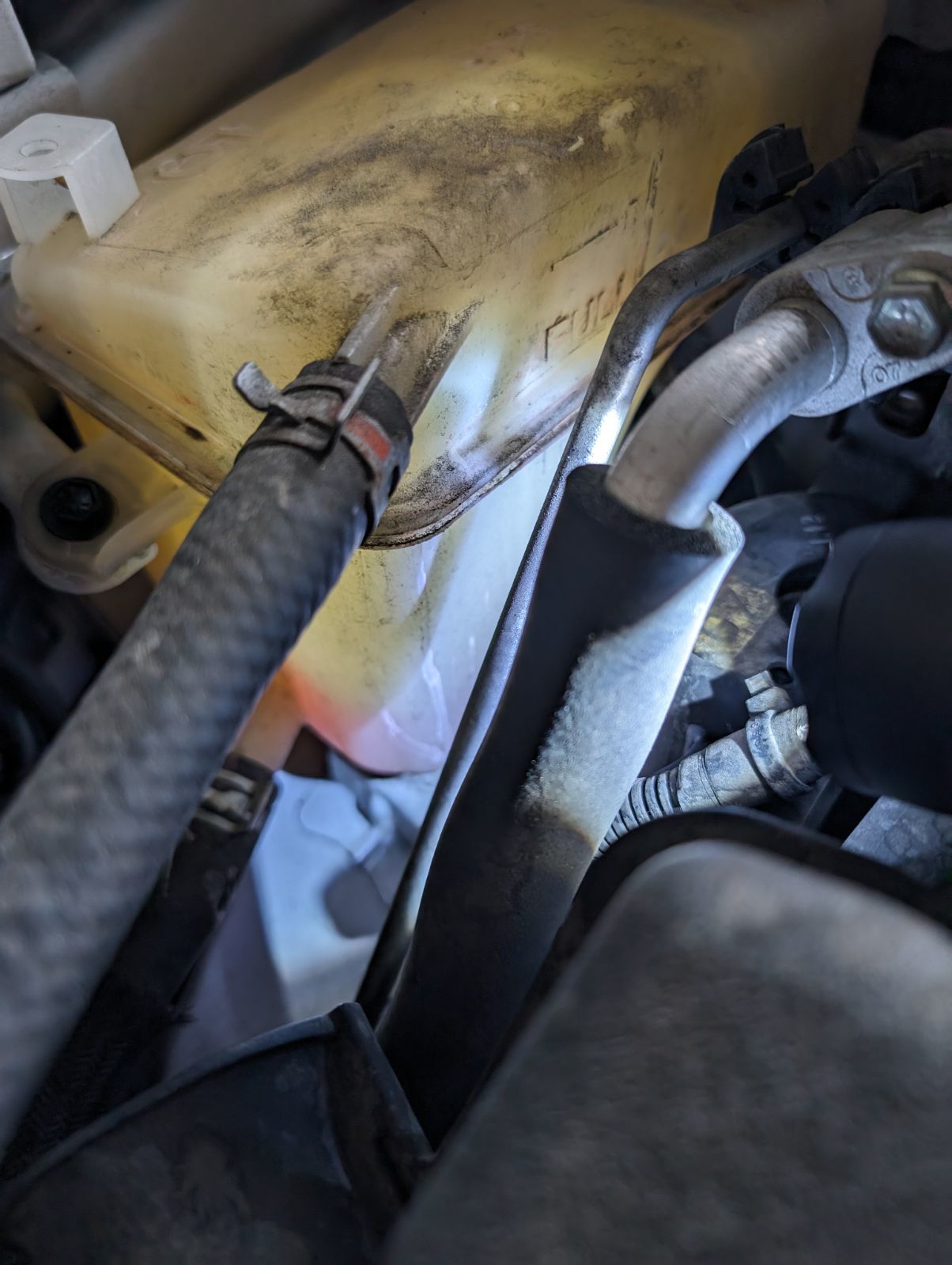

  8. CA2012PriusOwner
    CA2012PriusOwner New Member
    Jan 25, 2024
    This is where the coolant level dropped to due to the cap being left off:

  10. ASRDogman
    ASRDogman Senior Member
    May 29, 2018
    7,798
    3,978
    He's correct for the labor. He's mostly wrong for the parts failure.
    "Uncontrollable failure part"??? 90% wrong. It is controllable.
    It also works off pressure, which you were not getting, causing the coolant to overflow.
    Since there is less pressure on the impeller, it will spin faster, and faster.
    There needs to have the back pressure to push through.
    And when it got low, coolant wasn't flowing causing the engine to over heat.
    Which is very possible to have caused more damage, head gasket, warped head, scored
    cylinder walls, etc......
    Since you had NO problem before the work, it's not likely the coolant pump just failed.
    Any other engine damage will depend on how soon you turned the car off when the light came on.
    How many miles you have on it is minor.
