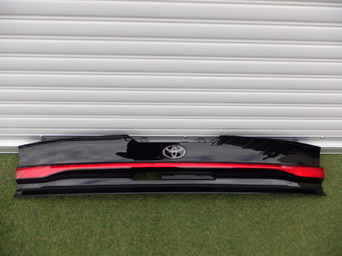

    For reference here is the part number (based on 10 minutes of searching) you can use to price what it would cost out of pocket to buy the replacement part.
    Here is a link for a listing with pics of the part on aucfree.com
    Lens And Body, Lamp. Tail Lamp. (Rear) $375
    81581-47080
    This second price is from the impex japan site. Have not purchased from them myself but others have and reported positive experiences. Takes some time to ship and shippin not included in price I understand.
    Lens And Body, Lamp. Tail Lamp. (Rear) $147
    Poseidon and Gokhan like this.
