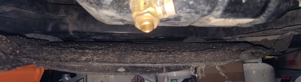

    The main engine shield is drooping in front of the oil pain.
    • AFAIK, there aren't supposed to be any clips holding it up
    • My guess: as long as the oil change flap was still there, it probably provided some stiffness.... but is long gone.
    This is the lowest underbody point on my car, giving it quite poor clearance.
    Has anyone implemented a good workable solution?
    My initial thought: install a stiff plastic (plexiglas?) bar above the shield, zip tied to the sheild in several places, thus holding it up.
    There's GOT to be a better solution than that... I hope!

    You have my 20-year-old brass automatic flippable oil change valve I've had three of those things for like 30 years now since about 84 for the sloppy piece of plastic just take a what is that a quarter inch piece of metal you channel and shoot two or three small sheet metal Phillips screws in it hold it right up won't even know it's there probably stay there for a good long time just a small imagine it's like quarter inch you channel right in the home Depot metal section just a little piece what four six eight inches long put it on the engine side with the you faced up. And then shoot the screws from the ground side.

    There are numerous aftermarket underbody panels, yes, the whole cover, oil change door and all, for sale on Amazon for less than $100.
    Sure, the plastic is probably not as thick and sturdy as the oem part. Also, you will have to remove the absorbent mat material from the oem cover and transfer it to the new one. You should probably also reinforce or replace the oil change door hinge while it is clean and not yet torn and beat up.
    If it was my car, I'd also try to reinforce the cover with some thin aluminum strips or other material to make it more sturdy and less vibration prone.

    (@PriusCamper LOL... have I really been posting about this droopy thing? I willingly admit, I have a finely tuned forgettory, so it's possible. Didn't show up in my previous search. That IS a good hint for others though: searching directly on this site often doesn't produce much, but doing the same search on Google can find what you're looking for :-D )
    Yeah, I *could* change out the whole thing. Yet: how many of us have vehicles with the oil change flap gone? Seems that's incredibly common. Are THAT many of us driving around with droopy shields?
    It's the metal/plastic reinforcement that I'm considering. Why bother with the cover...
    A good search: site:priuschat.com "underbody" shield alternatives
    Best solution I've found: I fixed the @#&% oil door! | PriusChat
    MAX2 likes this.
