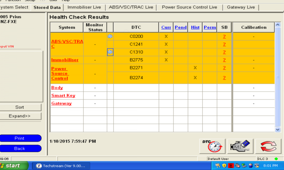

    Finally got Techstream and I have a whole bunch of codes, C0200, C1241 and C1310 are all current (I assume that whats the Curr category means) on the ABS/VSC/TRAC. I also have B2775 current on the Immobiliser and B2271 and B2274 historical (again assuming on the hist category) for Power Source control.
    C0200 seems to be related to a bad speed sensor on my right front wheel. c1241/C1370 are skid control ecu. I have attached a screenshot of the error codes.
    These may not be related to the crossed cables/battery replacement. I have noticed that the car makes a lot of noise from the front right when braking until it gets "warmed up" it would
    Any advise on any of those codes is appreciated.

    You are right about DTC C0200 pointing to the right front speed sensor. I suggest you remove the sensor and inspect its tip as well as the toothed wheel which is part of the hub assembly.
    DTC C1241 means that the skid control ECU sees low voltage from the 12V bus. Relays ABS 1 and ABS 2 are the most likely culprits - unless your car suffered accident damage to the rear of the car, damaging the wiring harness leading to the brake power supply located next to the 12V battery. Or your car suffered a rodent infestation and the wires leading to the skid control ECU (near the steering column) were damaged.
    DTC C1310 means that the skid control ECU thinks the hybrid vehicle ECU has a problem.
    DTC B2775 means that either the transponder key ECU or the Smart ECU have a problem.
