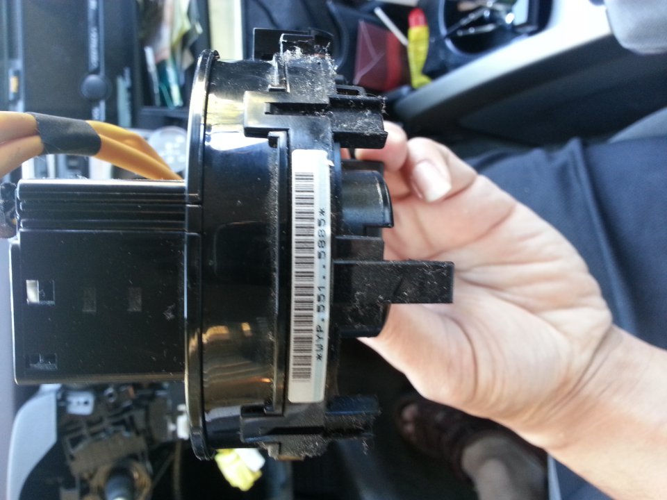

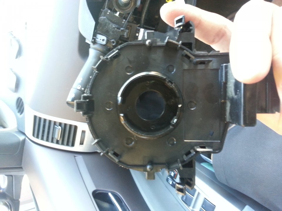

    Here is what the clock spring looks like:
    uart and cwerdna like this.

    Okay People, I got the clock spring and installed it today. It appears to work much better. I can turn the steering wheel in any degree and engage the cruise, which was not the case with the old clock spring. I was going to do a write up, but there are plenty of posts in regards to the clock spring. Thanks for chiming in people. Peace.
    dorunron likes this.
