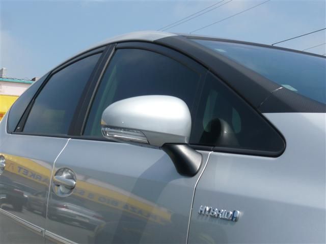

    I think the Venza mirror is compatible. Got my V with JDM as seen below:

    Looks sweet! I have the same color. Do you have a post/ pics of how to do this on the V ?

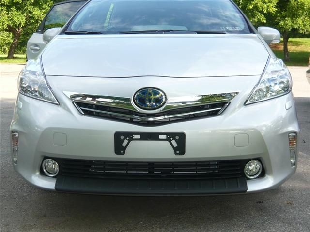

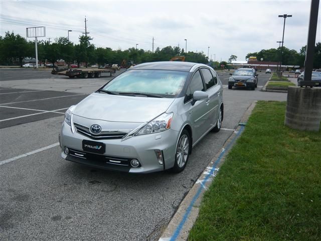

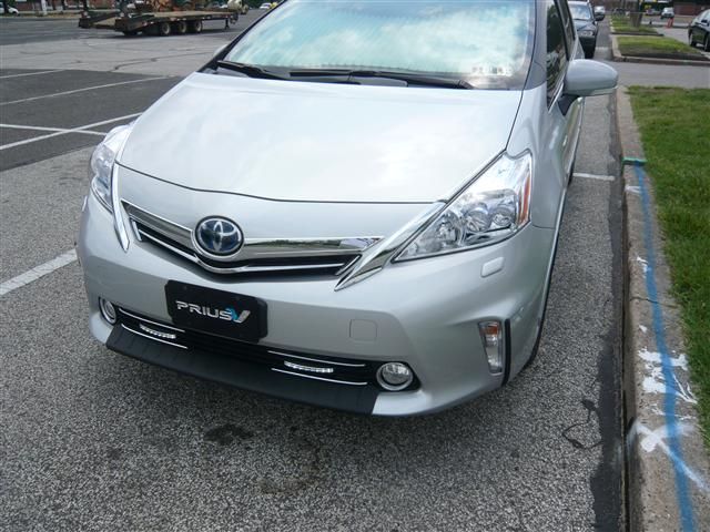

    Yes, I put the rear bumper protector on the front.

    I like that idea of using the bumper protector

    Looks great. Where did you get these Chrome covers for the up bumper?
  14. tanasit
