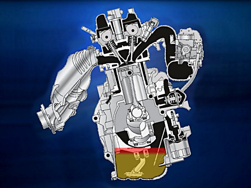

    The Prius is a wet sump, there is no oil pan that oil flows into and out of as the engine is stopped and started. The bottom of the crankshaft is very close to the top of the oil when it is cold and the oil expands as it heats. Too much oil and the crankshaft starts to drag in the oil.
    Hobbit's helpful picture:
    Brown area: normal. Red area: overfilled.
    No, you don't underfill the oil. You make sure it is between the low and MAX marks on the dipstick when measuring with the proper procedure - run it fully up to temperature, switch off, allow five minutes for oil to return to the sump, check the level. To check the level, remove the dipstick, wipe it clean with a rag or paper towel (lint-free if possible), return it fully home and pull it back out. If you do this properly there shouldn't be much difference in the level around the stick and no confusion about what the level is.
