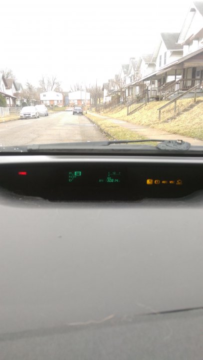

    Without the speedometer being lit up, the car may be "on" or in "accessory" mode in the picture, rather than in the "ready" mode to drive. My 07 looks like this when in the accessory mode:
    Imgur
