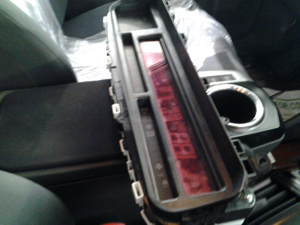

    We purchased a 2014 V in late August and by mid September we started see blotches. They started small and grew. We had driven the car through some hard rains with the defrost on high but that should not have put moisture in area of the car. The dealer claimed they have not seen that problem and scuffed it off as possible over spray of Armour All during dealer prep. But these spots just grew as if they were some form of crystal and started to blur the display. The dealer is replacing the whole display unit and the service rep said thanks to low miles they would cover it which has me worried since we have not done any thing to have caused it and it must be a factory quality control issue. The part is on back order now. This is not a part you can get to unless you know how to dismantle the dash. This picture is the module removed by the dealer and sitting on the center console. Its not in sharp focus but you can see the blotches. 0925141132b.jpg 0925141132b.jpg

    These blotches were on the electronic module and not on the surface of the plexiglass that protects the module. The dealer could not remove them and had to order a new module. Believe me this was some contamination of some sort that must have happend when they were putting the car together. The dealer would would have wiped it up and given the car back to me instead of a rental.
