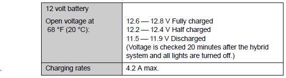

  8. szgabor
    szgabor Active Member
    Jul 29, 2009
    993
    175
    Oceanside NY
    6 Amp is too high !!! maybe the 10 minutes is OK but NO way to put it on for 3 hours !!! I think the manual says less then 4.2Amp

  18. Easy Rider 2
    Easy Rider 2 Senior Member
    Aug 5, 2014
    1,584
    257
    Ocala, FL
    What model Prius and what page in the manual.
    I don't believe that I have EVER seen the capacity of a battery charger specified in TENTHS of an amp.
  19. fuzzy1
    fuzzy1 Senior Member
    Feb 26, 2009
    17,317
    10,167
    Western Washington
    Pages 434 and 567 of my 2012 Prius Three manual list a maximum charge rate of 5 amps.
    I remember seeing the 4.2 amp limit in print. But because of Toyota's wonderfully concise Index, I can't find it now. It might have been in the manual for my previous 2010 Prius-II instead.
  20. Mendel Leisk
    55,541
    38,709
    Found this on page 563 of my pdf of the 2010 Owners Manual:
    dorunron likes this.
