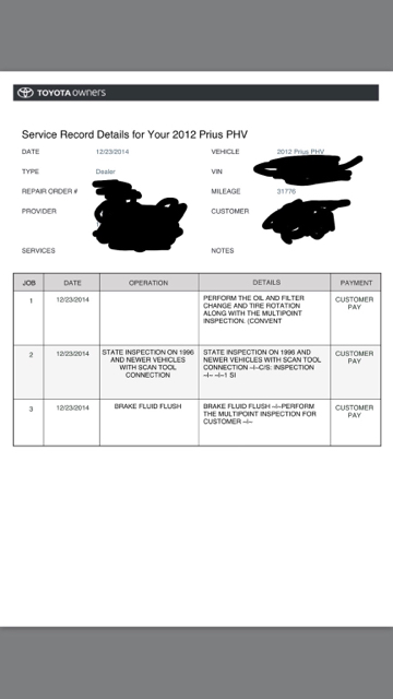

    This is a 30k receipt:

    Can't see the 30k receipt.
