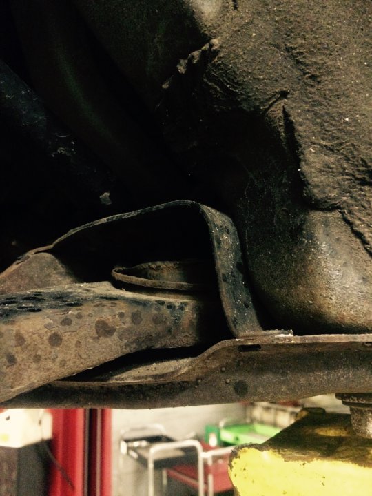

    OK, got my car back, bearing noise is no more. Spoke to the service manager. He showed me on his computer the Toyota control arms are $240 each and the book says 3.6 hours labor. He padded the labor to 4 hours since everything is rusty. I showed him the Amazon part. He said if I brought it in he would use it, so there's a $400 saving right there. He also took the picture below. Awesome, thanks, I hadn't even asked.

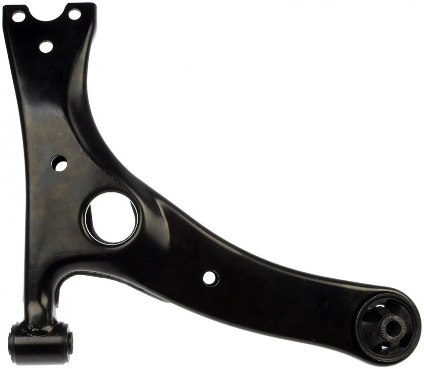

    You can see the big dounut bushing has dropped out. Here's what the new part looks like. This seems like a screwy design to me. The smaller bushing is oriented in the correct plane for suspension travel, but the big one is in torsion. No wonder it wears out.

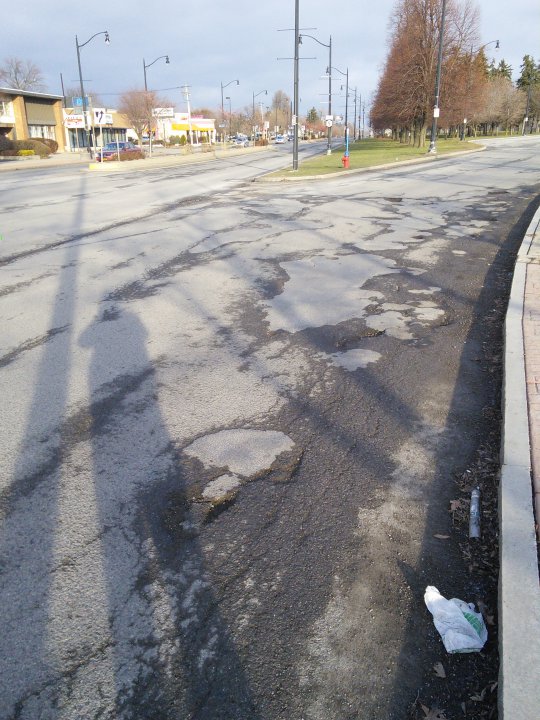

    Oh, and if you come to Buffalo here's what main st looks like. The wings are good though.

    Oh man the LCA's
    Are so corroded the mount rotted out.
    That's a first
    Have not seen that yet here. the whole front end
    Must be rotted.

    The bushing that's twisted in the photo is mostly twisted because the car's on a lift and the arms are hanging down at their maximum extent. When the car's sitting on the ground it's a different situation.
    This looks like a legitimate assessment on the part of the service dept and it sounds as if they're willing to work with you (and provide a useful photo!).

    With all due respect, 9 years service in Buffalo does result in chassis rust--but that just looks like the bushing has dis-bonded from the ring it's molded to. I replaced both lower control arms on one of my other cars at 9 years for the same issue.
    It's what I call a "comfort bushing" and absorbs impacts when the front wheel hits bumps.
    In my case I'd hear a crank or screech on bumps when mine went.
