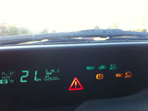

    After a couple of resets, I was able to start the car again and decided to drive home instead of the dealer. On Monday on the way to the dealer, the car stalled and would not come back to life. see photo.
    [​IMG][​IMG]
    I had to be towed to the dealer who charged me $109 to tell me I ran out of gas and they reset the code for me.
    But as you can see from the photo I still had 4 bars. Why does the dealer insist I ran out of gas - and is there anything else that could be causing this? They say they've never heard of an idle air control sensor going out on a prius.

    welcome to priuschat! what did they say about the four bars?
  3. Kimncris
    Kimncris New Member
    Sep 11, 2013
    Allen, Texas
    Thank you. They said I must have put that gas in after I ran out. After I spok with the manager they just said - huh- well bring it back if it does it again.

    Does it make sense to you based on you previous fill-up data?
    If it happened to me I would know I filled up with 8.x -gal at 12x,yzx miles on the prior fill-up.
    If your are not filling up each time, I don't know if you can fake out the "guess" gauge.

    Not really. The half tank or so was about right after coming back on that long trip. I filled up at two bars and it put in 8+ gallons.

    As far as mileage it looks like it was about 330 miles to the four bars. Assuming the dealer did not add gas- I drove another 50 or 60 after the service and filled up at two bars again.

    OK that makes sense. Sometimes 330 miles could mean 4 bars like you had...that is just like my current fill-up we got a lot of gas in there 9 gals. So now we are like you. Other times the fill-up is not as full and 330 miles could mean near empty. If you are correct, 8 gal at 2 bars, that would suggest fairly full tank so 330 miles should be 4 bars, and therefore the mishap is not explainable by me.
