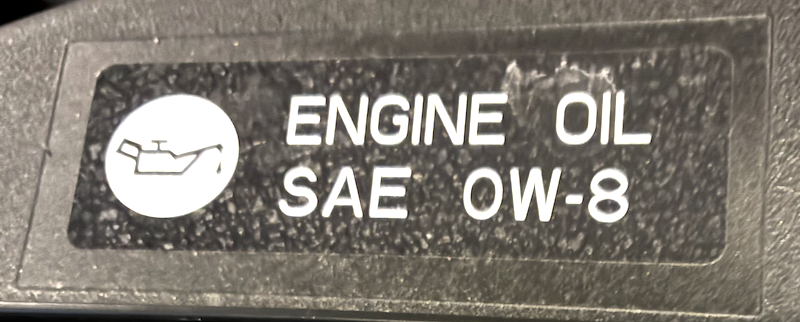

    Of course, as a GEN5'er there's this:
    Misterman74 likes this.

    I'm thinking of bringing along a container of Mobil1 0-8w in case the dealer hasn't run out of the 0-16w yet, although at this point in time they should have.
