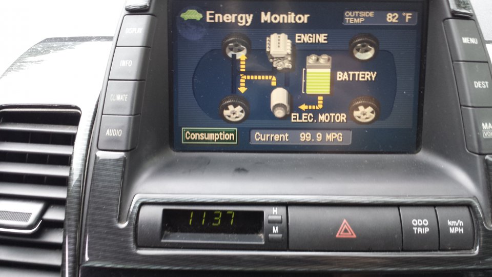

    I have read not to freak out seeing green or purple bars... That it is rare but does happen. Green means 80% and purple 20% battery power. My battery goes green 1-2 a day it seems. Around 10 times over course of a week 300-400 miles. I see it go purple around 4-5 times a week. My Mpg seems decent regardless. Also today i saw my car in battery only mode at 55mph and it also slipped in ghost mode for a second at that speed. Thought the cut off was 45mph for that.

    Btw it wasnt at green bars when it went to battery at 55mph

    1 bar is 40%.
    I go purple every day and green every day. It's not rare, it is just not the most common while driving. If every time you brake it goes green and every time you accelerate it goes purple, then you have a problem. Other than that, no worries.
    The car can use battery only propulsion at any speed, even triple digit speeds. It is all based on power requested versus power available. The car makes the choices. You can force it by jabbing the pedal and things like that, but if you just drive it, then it works. In Pure EV mode, people have got the Prius almost to 80mph with no help from the engine on flat terrain.

    The engine will be spinning but not necessarily producing power above 41 mph, in order to keep MG1 from over revving. The Prius engine is surprising in how little friction it makes in free wheeling mode.
